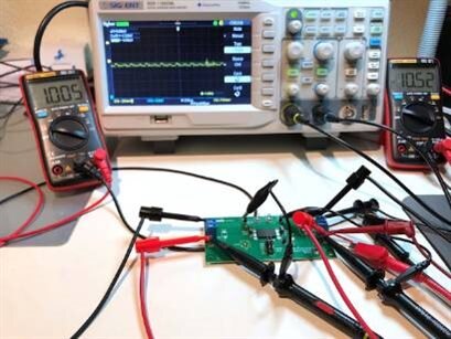

The Grand Prize winner of the Experimenting with Polymer Capacitors Design Challenge is fmilburn.
He wrote three official blogs, experimenting with different ways of measuring ESR and wrapping up with another experiment on adding bulk capacitance to a buck converter (TPSM84A21 10A SWIFT Power Module ) and comparing the Output Ripple (mV) with and without the bulk capacitance. His experiments were well documented with videos, screenshots, graphics, charts, tables -- everything one expects in an experimental report. to read his project blogs: Experimenting with Polymer Capacitors
