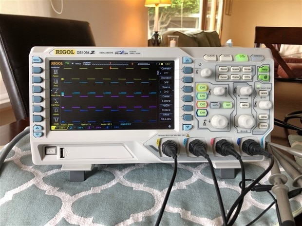

Setup and First Impressions
All three were set up in same climate controlled space and warmed up for the same amount of time.
{gallery} My Gallery Title
Keysight DSOX1102G: 100 MHz Oscilloscope with WaveGenimage
Rigol DS1054Z: 50 MHz 4 Channel Oscilloscope upgraded to 100 MHzimage
Siglent SDS 1102CML: 100 MHz Oscilloscopeimage
All three were easy to set up.  The controls, menus, and placement differed enough to slow things down going from one scope to the other but all are manageable.  This is touched on further below.  All three are running the most recent firmware available from the manufacturer.  All scopes are using the probes provided when purchased and probes have been compensated per the manufacturer’s instructions.

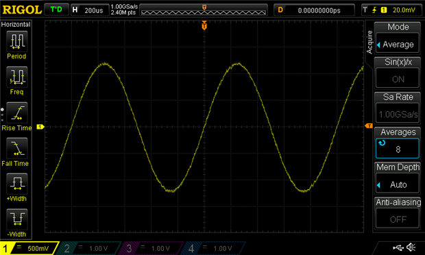

Lab 3 uses the waveform generator on the Keysight to generate a noisy 1 kHz Sine wave.  The noise is sufficient to generate an occasional rising edge trigger outside of where expected.  There is built in hysteresis of approximately 0.5 divisions on the Keysight so the unwanted trigger only occurs when the noise exceeds that level.  Since the vertical resolution has been set to 500 mV per division, the noise in this instance is occasionally exceeding 250 mV.
Below the Keysight is shown with the default trigger setting and a noisy Sine wave.  The scope occasionally has unwanted triggering on the noise as it passes the trigger point.
There are two ways to reject noise on the Keysight:
  • Noise rejection which raises the trigger hysteresis to 1 division
  • HF rejection which rejects frequencies above 50 kHz in the analog trigger circuitry
Since the Sine wave is 1 kHz and the noise is less than 1 division then either rejection method will remove the noise from the trigger.  In the screenshot below the trigger is set for both noise rejection and HF rejection but either is sufficient to remove the unwanted trigger.
It is possible to smooth the waveform and remove noise by setting the acquisition to 8x averaging which allows for more accurate manual measurement as shown in the Keysight screenshot below.
The Rigol occasionally triggered on noise the same as the Keysight.  Noise reject and averaging worked as expected and similar to the Keysight. It does not have a high frequency reject for trigger.  A screenshot of the Rigol with trigger noise rejection and 8x averaging is shown below.
The Siglent did not trigger on the noise with vertical set to 500 mV.  It started to trigger on the noise when vertical resolution was at 200 mV and not all of the wave was visible in the viewing area.  It rejected the noise most of the time, but not all of the time when Noise Reject was turned on. It does not have a high frequency reject for trigger.  The cursors look fine on the Siglent display but intensity could have been turned up for the screenshot.
Summary:  Removing noise was possible on all of the scopes.  All scopes have a noise rejection mode.  The Keysight also has the ability to do fixed 50 kHz frequency rejection in the trigger circuitry (but is not suitable at frequencies above 50 kHz).  The Siglent has a larger default hysteresis window (greater than 0.5 divisions).

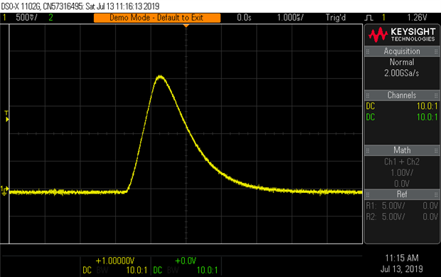

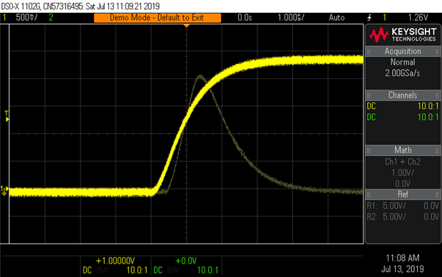

Capturing a Single-shot Event
Lab 9 describes a single shot event and the scope settings to capture it.  The training signal is a single shot pulse with ringing.
Here it is captured without problem on the Keysight.
The Rigol and Siglent also captured it without problems.

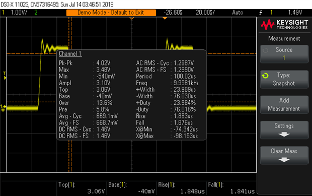

Automatic Parametric Measurement of Digital Waveforms
Lab 10 demonstrates the many automatic parametric measurements that can be done on a digital oscilloscope.  A repetitive pulse with ringing is set up on the training signals.  Up to four parameters can be displayed at the bottom of the scope along with cursors indicating the last one entered.  The following screenshot shows top, base, rise, and fall at the bottom of the screen for the Keysight with cursors framing the fall time.
A quick capture of all the parameters can be done with a “snapshot” that tends to overlay the signal since it is placed in the middle of the display.
It would be nice if Keysight moved the summary table off of the center of the display.
Greater flexibility is available on the Rigol for individual parameters.  There is also the ability to do a quick capture of all signals and the signal can be placed such that the information does not obstruct it. However, I find the information somewhat harder to read due to size and layout.
Of course the Siglent has its own way of doing things.
Summary: All of the scopes do automatic parametric measurement.  It would be nicer if the Keysight did not place the full summary directly in the middle of the screen.  I prefer the layout of the Keysight information in general though that is subjective.
