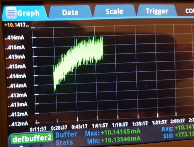

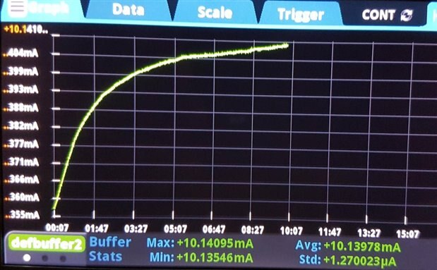

    Sorry to add more to the comments section, but just to provide one more data point:
    Today was cooler, at about 21.6 to 21.3 degrees C (It was 21.6 degrees C, but I opened and closed a window part-way through the experiment, to try to make it colder), and this was the current output, at close to switch-on, you can see that it started at about 10.1355mA, and at 10 minutes has increased by 5uA, i.e. to 10.1405mA, and still rising due to me messing with the window:
    And now it has been more than an hour at this 21.6-21.3 degC temperature, and it looks like it is settling to 10.1416mA:
    (Just to recap, yesterdays experiment at 23.8 degrees C settled to 10.1408mA). I'm running it at the same 5V input, same bowl, etc.
    So, this means a drift of around -32 to -36ppm/degC (yesterdays guesstimate was -30 to -80ppm/degC). Maybe it's not possible to improve further without better resistors, i.e. lower tempco resistors. I'm looking forward to seeing your final design, I'd love to assemble one!
