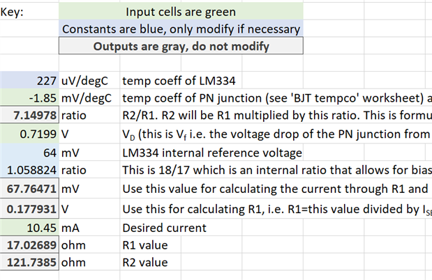

    Hi Shabaz,
    I set up a spreadsheet to calculate R1 and R2 and input the values you determined empirically (nice tests by the way).  Here is an example of input and output:
    Note that the calculated R2 / R1 is 7.8 and not the 10 from the datasheet.  I got pretty close to these values by using two resistors in series:
    R1 = 15 + 2.2 = 17.4 measured
    R2 = 100 + 33 = 134 measured
    I started with the diode I already had in the circuit, IN4148.  I measured the current through it to be 4.23 mA and the voltage drop to be 687 mV which is lower than the Vf your diodes are showing.  The  current out Iset (which ideally would be 10 mA) was 9.83 mA.  I plan to redo the calculations for the actual Vf and / or change out the diode but thought I would post this in case I don't complete it tonight.
    Since it is sensitive to Vf and maybe other stuff, I will try a trimmer pot to see how well that works also.

    One final post for the night...  I put the numbers into the spreadsheet for the IN4148 - Here is the resulting calculation:
    For R1 I am still using 17.4 Ohms so that is off a bit.  For R2 I took out the 33 Ohm resistor and replaced it with a 100 Ohm trim pot as the datasheet says to vary R2.  Then I fired up the circuit and adjusted R2 until the current was measuring exactly 10.00 mA.  The measured resistance for R2 was 130.5 Ohms and above it was 134 Ohms.  So a 3.5% change in resistance was needed to correct a 1.7% original error in current.  My feeling is that a trim pot is needed to insure better than 1% accuracy.  I am using a cheap trim pot but it seemed fairly stable.  The Newark site is down for me but it looks like you can get a single turn 50 ohm version with 100 ppm / deg C temperature coefficient for less than a dollar which I think would be acceptable.

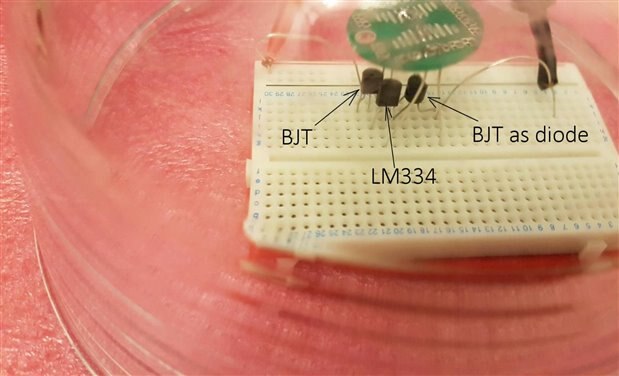

    Sorry I missed mentioning, that's a great idea to have the trim capability. You're right, the '334 possibly isn't the best approach if there will be different current settings : ( That could get very awkward. One possible option is to have a separate circuit per setting (since the '334 is cheap) but that could get tiresome quickly : ) especially if there are many settings, so some other current source method may be preferable for that.

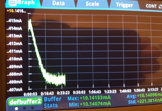

    I tried these settings today, although the test is still running. It's very sensitive to air currents cooling different parts at different speeds perhaps, so I put it on soft packaging foam and a bowl on top to try to seal it up..
    The two resistors are on the proto board:
    They're basically many parallel SMD resistors to get to the values needed. I'm using these settings currently:
    This is the results so far, just running at 5V since the it seems fairly insensitive to reasonable voltage changes. Apologies for poor snapshots from mobile phone:
    So, it shifted about 7uA from the start, but it did stabilise and reach some equilibrium, but it took 16 minutes to get there, and after that it's been sitting at 10.1408mA and unchanging. This is at about 23.8 deg C room temperature (I'm not measuring inside the bowl but outside). I don't know yet what shift there will be when the room temperature changes!

    shabaz over 7 years ago in reply to fmilburn
    Hi Frank,
    I'm using:
    R1: three 51 ohm resistors in parallel (this should provide 17.0 ohms)
    R2: four resistors in parallel: 18.2k, 220R, 549R, 549R  (this should give 121.3 ohms)
    17.0 and 121.3 are a few tens of mohm lower than the Excel worksheet result, since the breadboard contacts will add a bit.
    I switched on the heating (and have been sitting in 25.2 degrees C - really hot!!) and from what I've seen, I don't believe the drift is any more than 80ppm/degC and might even be half of that. I can't be precise, because the bowl is Pyrex (i.e. heat insulator) so I lifted it for about 5 minutes in the now warmed room (and the readings shot up due to imbalances - so you'll probably find the same thing, that covering it is necessary!) and then put the bowl back on, and the value dropped to slightly lower than the 10.1408mA that I'd recorded at equilibrium before. It is still settling, but the room temperature is changing because I had to turn the heating off, I can't bear 25.2 degrees C any more image
    From all that, my best guesstimate is -30 to -80ppm/degC change (i.e. current dropped by about 0.3uA to 0.8uA with 1 degree C increase in temperature), and I believe that is going to be mainly from the resistors, since they were either 100ppm/degC or 50ppm/degC resistors (they were in my box of spare resistors, and I only checked that I picked 1% ones, I didn't look up the ppm).
    They were all normal thick film resistors since this was all I had. All were 0603 sized except the 220R resistor happened to be 0805 sized.
    So, if it gets a reasonably stable supply (a change of -100mV, i.e. down to 4.9V from the 5V that I was testing at, causes a drop of about 0.3uA) then I'm hoping it is definitely stable enough for milliohm measurements, but will be reassured by your findings, in case I made some mistake.

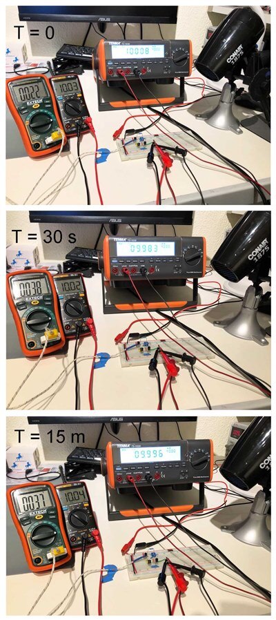

    Hi shabaz - wanted to make sure you saw this.  I also put a summary at the bottom of the comments.
    I am somewhat embarrassed to put my temperature test alongside yours but here it is.  I mounted a hair dryer on my PCB vise and pointed it towards the setup from a safe distance and on the low heat setting.  Another meter was set up to read temperature with an open air sensor alongside the components.  Temperature was observed to bounce back and forth 1 degree C during the test.   The test was done twice with similar readings both times.  Here is the setup.
    It behaved in a strange manner.  The current at T= 0 is 10.008 mA.  Temperature in open air at the location was immediately varying back and forth 37-38 C and stayed there.  Current started dropping very quickly and then started to recover after maybe 15 seconds.  At approximately T = 30 seconds it was 9.983 mA having recovered somewhat.  After a few minutes it slowly came back up to 9.996 mA where it stayed for some 10 minutes until I stopped the test after 15 minutes.  This is a mess of open air stuff but perhaps still useful.  The different components make the behavior nonlinear and they actually seem to compensate for each other after a while.  So it varied from about .017 mA per degree C to 0.01 mA per degree C.  Not as good as your results - maybe the resistors or just the crazy act of blowing hot air on it.  Still, not too bad.  Notice that the voltage reading across the DUT varied only between 10.02 to 10.04 mV for these three readings.  Funny stuff.
