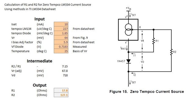

    This is a summary of experiments with the LM334 Adjustable Current Source as the comments are getting pretty long and possibly difficult to follow.  See the running dialog above for greater detail.  Shabaz has provided links to interesting information on an improved variation of the LM344 circuit and the advantages of using BJT transistors as a PN junction for temperature compensation.  He also ran a very interesting series of experiments to better determine the temperature coefficient of various common transistors as well as the diode recommended in the LM344 datasheet.  The forward voltage was also measured.  My experiments to date are consistent with cruder than his although and I have not run detailed experiments on temperature influence.

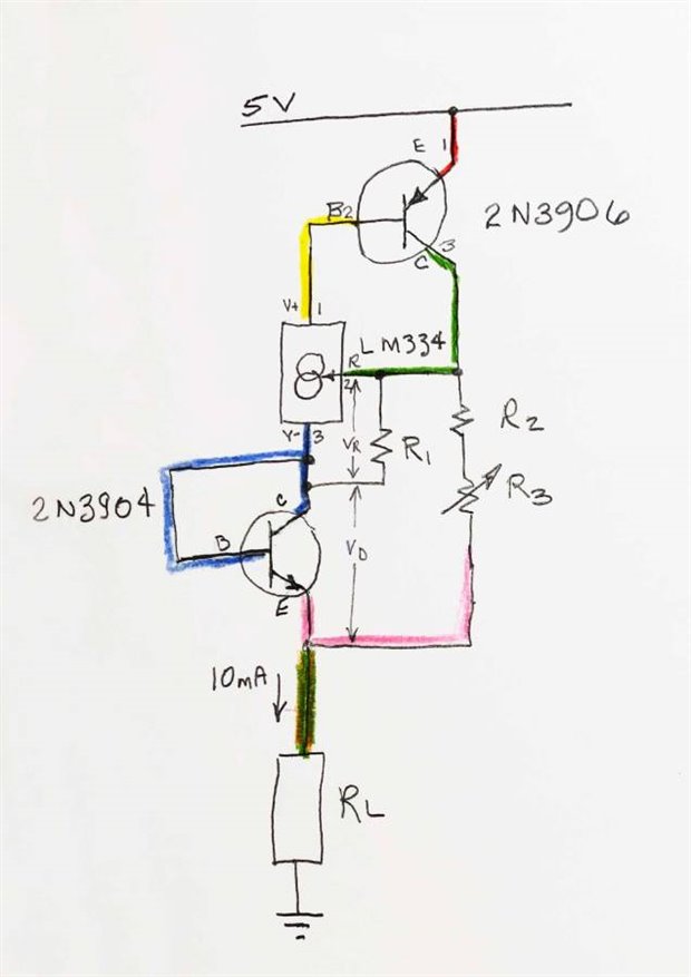

    Here is a circuit for a milliohm meter, modified using the information above, and using the LM334 to set current.
    The forward voltage drop across the 2N3904 transistor and the values of R1 and R2 in series with R3 are used to set the current through the load.  The tempco of the 2N3904 must also be known in order to properly offset temperature effects from the LM334.  The trimming potentiometer R3 allows error in the measured current to be corrected.  Spreadsheets were developed to make the calculations which are described in the LM334 datasheet easier as shown below:

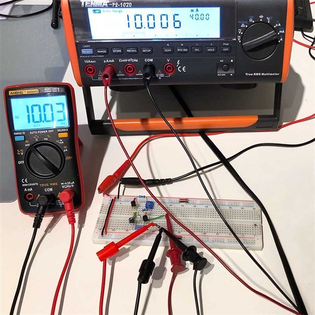

    My current experimental setup on a breadboard looks like this:
    During the test the following were relatively constant:
    • Input Voltage from Lab Power Supply: 5 V
    • Ambient Temperature: 19 deg C
    • Vf = Vd = 0.7183 V
    • R1 = 17.66 Ohms
    • R2 = 123.54 Ohms (includes trim pot, R3)

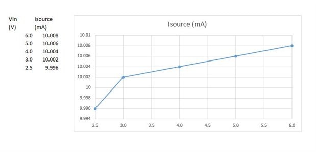

    The small meter at left is measuring the voltage in millivolts across the DUT which is a 1 ohm 1% resistor.  The larger bench meter behind is measuring current in milliamps.  Since the current is very nearly 10 mA and the voltage drop is very nearly 10 mV the setup is performing properly for a 1 ohm resistor.  The current was remarkably steady over the desired input voltage range of 3 to 6 Volts:
