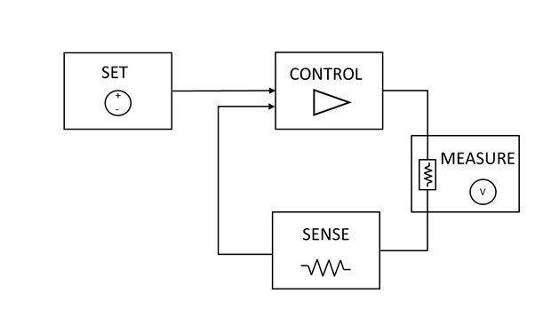

As is the usual case in electronics, and for that matter most engineering problems, there are many different approaches and potential solutions.  For this project we want to provide a constant current across the Device Under Test (DUT) and measure the voltage drop across it to determine the resistance of the DUT using Ohm's Law.  For purposes of discussion here is a simplified block diagram which omits certain details such as the power source.
The four blocks are:
  • SET:  This sets a value (in this case voltage) which will be use for comparison by the control block so see if the operating point needs adjustment
  • CONTROL:  The control block compares the set point to the sensing element operating point and makes corrections as needed
  • MEASURE:  This block measures the voltage across the DUT (shown as a resistive load) and reports it to the user in either ohms or voltage that can be converted to ohms.
  • SENSE:  The sense block feeds the actual operating point back to the control block so corrections can be made as needed.
It is worth noting again that this is just one way of approaching the problem.  For example, we could replace the three blocks on the left with a DC power supply with current limiting capability.  The measurement is easily done with a multimeter and would meet all the objectives above except for batteries.  But where is the fun in that :-)  Below is a summary of the design and areas for improvement.
SET Block:  In the last post I used resistors to form a voltage divider to form the set point.  The accuracy is then dependent on the voltage of the power source as well as the precision of the resistors and their temperature coefficient.  There are precision voltage sources that could be used to replace the voltage divider.  I have on order a LT6654BIS 1.25V, 0.1% +/- 10ppm/C voltage reference.
CONTROL Block:  I used a TLV2462a rail to rail op amp with negative feedback to drive the current to 10 mA.  Chopper op amps reduce the offset and temperature drift thus potentially improving accuracy.  The set point could be moved to obtain better accuracy.  I have on order MAX9619A and MCP6N16 op amps.
MEASURE Block:  I used a good quality bench meter and don't expect to improve on that.  In fact I will probably replace it with a less capable instrument to meet the objectives above.  I have an inexpensive 0-10V 5 digit meter on order from China but it will take a while to get here and who knows how good it will be.  I also ordered materials to make proper Kelvin test leads.   I am considering a microcontroller with ADC and this will be discussed in greater detail below.
SENSE Block:  I used a 1% tolerance resistor.  Resistors with better temperature coefficients and improved tolerances can be substituted.  I have on order 0.1% and 0.5% resistors with low temperature coefficients.
It should also be pointed out that there are other ICs that can be used and I have ordered the LM334 and TL431A.  But one of the originally unstated objectives is to learn more about op amps and that will be where I focus my efforts.
