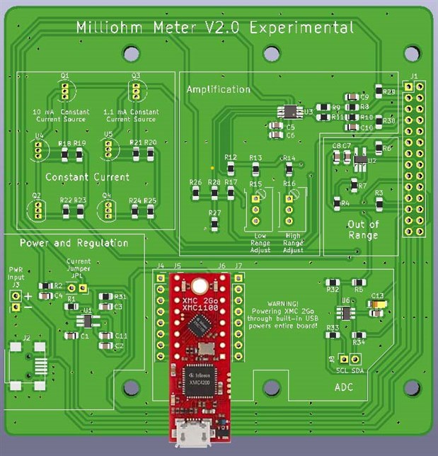

PCB
The new layout and design decisions are described below.
The noisy stuff and future digital stuff is on the bottom and analog is on top.  Power input and regulation is lower left.  All tracks in and out of the power section are widely separated with ground in between tracks and a clean ground plane beneath.  The constant current section is located just above it.  The ICs are spaced out in order minimize temperature influence.  The panel behind the constant current section and the power section could be vented.
The amplification of the differential signal from the Kelvin sensing clamps attached to the device under test are upper center.  I am curious about thoughts on the spacing of the feedback resistors and the trimmer pots.
All connections to Kelvin clamps, panel meter, and other user interfaces are on the 28 pin header to the far right.  A comparator to determine when the instrument goes out of range is sandwiched between it and the amplification.  In future it would be replaced an ADC for the microcontroller located bottom right.  A separate ground plane with star connection could be set up for the digital section.
Front view with silk screen:
Back View with Silk Screen:
All Tracks and Pads:
Front Copper
Back Copper:
Conclusion:
I plan to send off for a new set of PCBs by mid-week and given that it works will then start working on Version 3.0.  All thoughts and suggestions are appreciated.  And if anyone is interested in building one and has an idea let me know.  KiCad files are available as well.

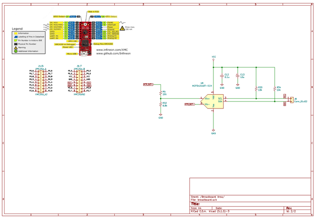

    I've added a new sheet to the schematic above with an ADC and microcontroller:
    Below is the revised board:
    I'm currently doing a RoadTest that came with two Infineon XMC 2Go boards and I decided to use one for this experimental version of the Milliohm Meter.  I have been looking for a small and inexpensive ARM chip to replace the MSP430 that I have mostly using up until now and the XMC 2Go has a M0 ARM microcontroller and is tiny enough to fit on the PCB and inside the enclosure.  I haven't made a decision on the microcontroller but any microcontroller could work and I can use flying leads if needed.
    The ADC to the right of it is the MCP3421 which is the same ADC in the little voltage meter that Shabaz recommended and works so well.
    I tried putting in a more general prototyping area but KiCad was giving me problems this evening.  For a change, I think it might be KiCad and not me and noticed I am using quite an old version so will update.  I fully plan to spin another board and this should be good enough to validate the changes made so far.  If the microcontroller and ADC work then can add reed switches? to auto-range, a new display, and power management.
    shabaz over 6 years ago in reply to fmilburn
    Hi Frank,
    I'm wondering if maybe the supply might need to be 3.3V for the SDA/SCL lines to the microcontroller (unless it is tolerant but I've not checked). Nice idea to try the XMC board, it's really fun developing for that chip. Incidentally by accident I discovered during experimentation for the Pocket-Nim game Creating your own Handheld Electronic Games – Pocket Nim that that XMC board consumes a lot of power due to the debugger. (Not normally an issue since that board is designed for USB use, but is a problem for battery operation). However the debugger can be disabled, but needs a wire soldered to one of the pads on the edge (described at that Pocket NIM blog post).
  • fmilburn
    fmilburn over 6 years ago in reply to shabaz
    Hi Shabaz,
    I believe what you are observing is bad practice in the way I labelled the schematic - I should just label 5V, 3V3, etc. - and will fix.  The label VCC is used for the first time on the output of the LDO thus the supply for SDA/SCL is 3V3.  If you still think I have it wired wrong rather than just label confusion please let me know :-)
    I will go back and have a look at Pocket Nim.  So far I like the XMC board and versions of the IC are available in a TSSOP package so it could be added to the board and soldered at home with some care.
    Hi Frank,
    Oh I see. I didn't realize that was a different supply rail. Your plan sounds good, a directly soldered TSSOP eliminates the debugger current consumption issue!
  • fmilburn
    Thanks for reminding me of Pocket Nim. I had forgotten that you used the XMC 2Go and your project has a very nice section on programing with DAVE.  To my surprise when I first looked into this board Infineon also adapted it to Arduino.
