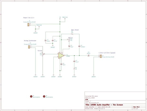

Circuit
The circuit is yet another LM386 audio amplifier with a few twists.  Some of the usual modifications have been made:
  • Additional decoupling for the power supply
  • Addition of bass boost (fixed resistor)
  • Addition of gain control
  • Bypass capacitor on pin 7
  • Large output capacitor
For a bit of a change it will be made with SMD parts on a custom PCB (with artwork :-).

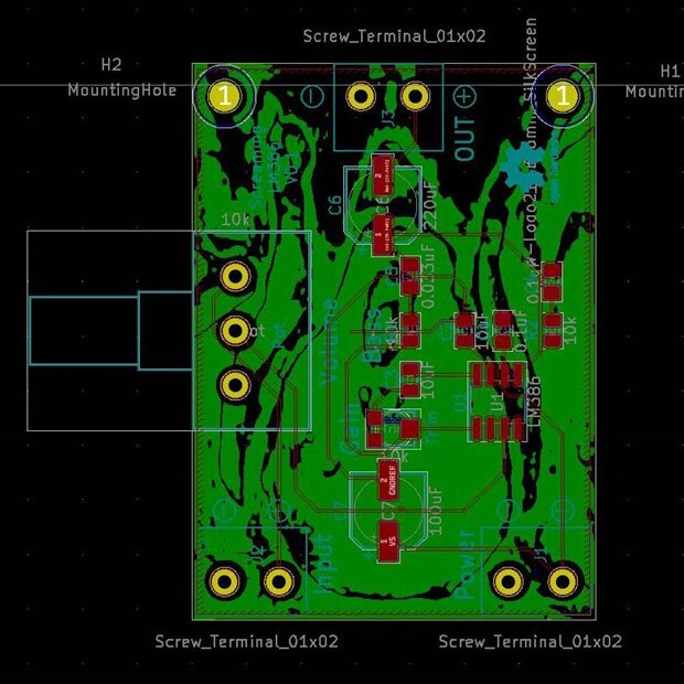

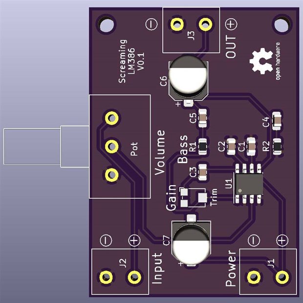

PCB Layout

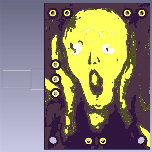

Renders of the design, front and back, are shown below.  It looks like a Screaming LM386 doesn't it?
{gallery} Renders of the Screaming LM386
Front
Back
In my opinion it does not degrade the design too much and with the screw terminals and mounting holes it is more functional.

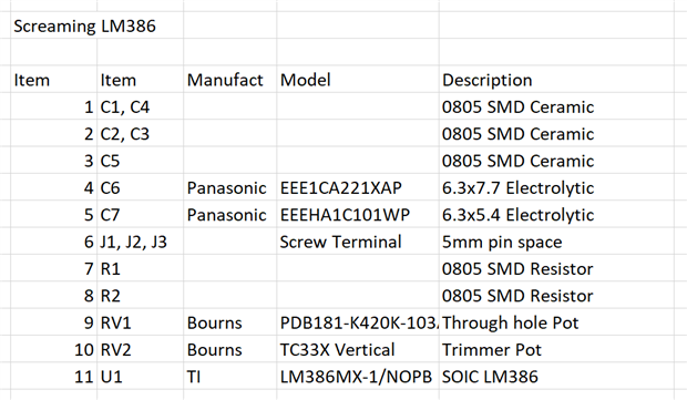

Bill of Materials

    I went ahead and made the order to OSHPark this evening but made two small changes: Decided I was being too timid and went ahead and connected the back copper to the ground plane with two small traces…
    genebren over 6 years ago +3
    So far the artwork is looking good. It would be interesting to integrate the artwork into the actual circuit (either as traces or ground plane). Keep up the good work!
    • Decided I was being too timid and went ahead and connected the back copper to the ground plane with two small traces.  I should be able to cut the traces if it screws things up but I think it will be OK
    • Determined that I had the volume pot hooked up in reverse and changed that
    This is what the renders from OSHPark look like:
