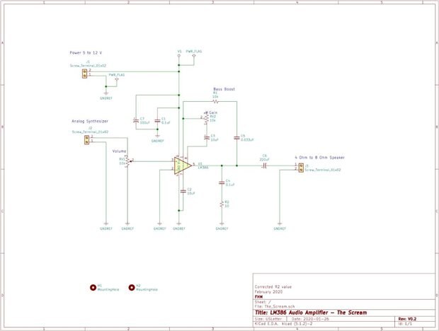

The circuit is yet another LM386 audio amplifier with a few twists.  Some of the usual modifications have been made:
  • Additional decoupling for the power supply
  • Addition of bass boost (fixed resistor)
  • Addition of gain control
  • Bypass capacitor on pin 7
  • Large output capacitor
For a bit of a change it will be made with SMD parts on a custom PCB (with artwork :-).

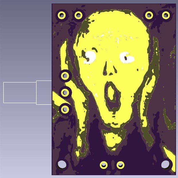

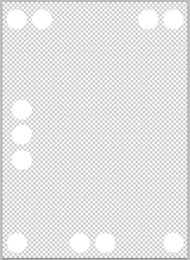

There are some issues to address when using artwork with a working circuit on the PCB.  The artwork itself is a footrpint and the Design Rule Check (DRC) may not catch errors when when vias or or through hole parts penetrate into the footprint.  Among the ways to address this are:
  1. Make a one layer board with the art on the back and don't penetrate the PCB
  2. Penetrate outside the PCB footprint - the PCB must be larger in area than the art
  3. Carefully penetrate only grounded areas for grounds in the artwork (may not look good)
  4. Carefully penetrate only bare areas for wires in the artwork (may not look good)
  5. Mask out of the art design for circuitry (may not look good but could be a feature)
Approach 1 only works if there are no through holes or vias.  Approach 2 means the artwork will be reduced in size.  Approaches 3 through 5 modify the artwork appearance and may or may not look good.

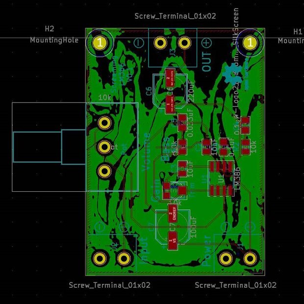

My approach turned out to be a combination of 1 and 5.  Approach 2 would enlarge the board and increase cost or reduce an already small art design further.  Approach 3 and 4 seemed to have risks for the first attempt at this and were discarded.  The circuit itself is all on one layer but because screw terminals and mounting holes were desired for this design it was necessary to have penetrations.  Accordingly, the art itselt was modified by masking out around all the holes in Photoshop.  The new images were imported into KiCad and converted into a footprint as described in the previous blog.  The footprint was then placed on the back of the PCB and the circuit drawn on the front layer.

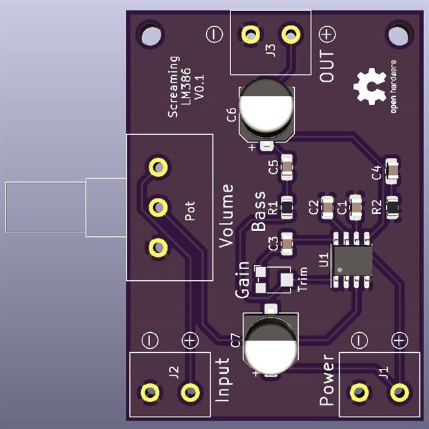

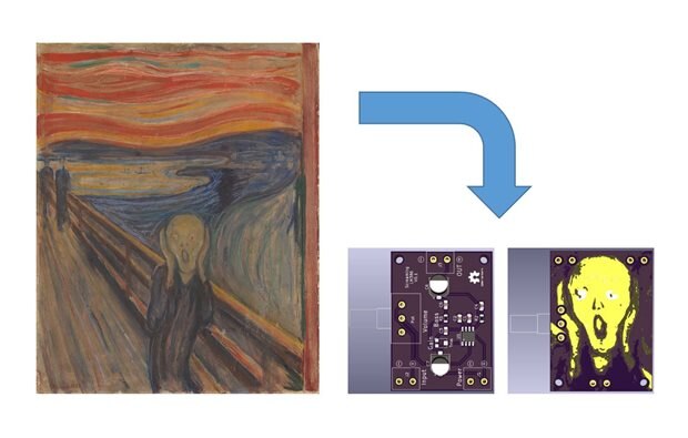

Renders of the design, front and back, are shown below.  It looks like a Screaming LM386 doesn't it?
{gallery} Renders of the Screaming LM386
Front
Back
In my opinion it does not degrade the design too much and with the screw terminals and mounting holes it is more functional.

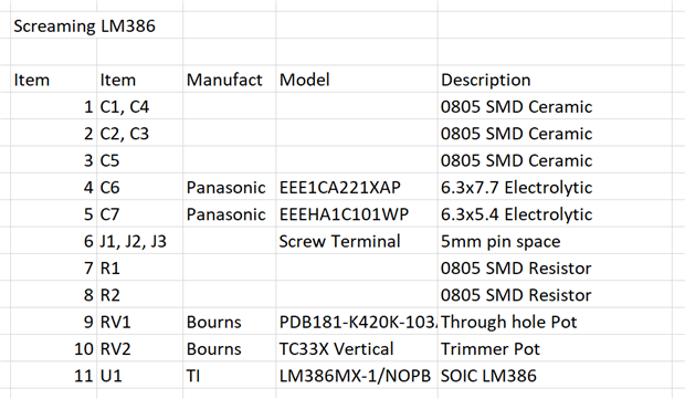

Bill of Materials

    I went ahead and made the order to OSHPark this evening but made two small changes: Decided I was being too timid and went ahead and connected the back copper to the ground plane with two small traces…
    genebren over 6 years ago +3
    • Decided I was being too timid and went ahead and connected the back copper to the ground plane with two small traces.  I should be able to cut the traces if it screws things up but I think it will be OK
    • Determined that I had the volume pot hooked up in reverse and changed that
    This is what the renders from OSHPark look like:
