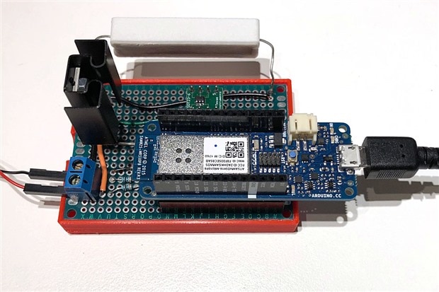

8 July 19 Update
I soldered a little protoboard to play with before deciding what to do next.  The idea was to make something more reliable mechanically and allow some thermal testing and firmware development.  The design still uses the DAC on the Arduino MKR1000 , OPA192 op amp and the MTP3055VLMTP3055VL MOSFET.  The one ohm resistor was picked up cheap locally and measures 1.003 ohms using the milliohm meter.
Female headers were soldered in so that the parts can be easily removed and reused in future.
Here it is populated.
If you have a 3D printer, then you have to print stuff.  Here it is in a little tray.
After fixing a wiring mistake where I confused pin 5 on the op amp with pin 5 on the carrier board (pin 5 on the op amp leads to pin 6 on the carrier) everything was working.  There seems to be an intermittent bad connection between 5V on the MKR1000 and the op amp - one of the main reasons the board was constructed was to avoid this!.  The DAC is accurate in the range tested so far as is A1 which measures the input voltage.  A2 which measures the voltage (and thus current) just above the resistor has about 17 mV offset which seems high but I should consult the datasheet to see if it is in spec.  It can be corrected in firmware.

  • michaelkellett
    michaelkellett over 7 years ago +9
    I expect that with some settings and loads your current sink will oscillate. You'll be able to mitigate this with the following changes: about 47R between op amp output and MOSFET gate 4k7 MOSFET source…
    4k7 MOSFET source to op amp -ve
    100pF op amp output to op amp -ve
    These are starting values - if you have a spice model for the MOSFET you can tune by simulation.
    Sometimes a resistor in series with the feedback cap helps..
    Otherwise you can tune with a scope while applying pulses to the op amp +ve input, either with a
    signal generator or software to the DAC.
    MK
