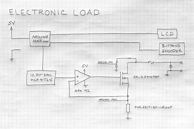

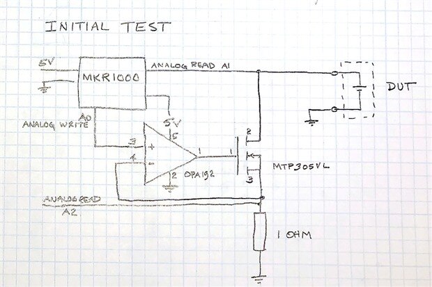

Concept Demonstration
What was on hand is shown in the following schematic:
An Arduino MKR1000 output a voltage using the built-in 10 bit DAC which through an OPA192 op amp and MTP305VL MOSFET control the voltage above the 1 ohm resistor.  One volt output from the MKR1000 equals one amp to the device under test.  In this case the DUT is a 18650 battery hooked up to a boost converter to give roughly 3 Volts.
I was surprised at how good the DAC was on the MKR1000.  The MKR1000 ADC had an offset of around 18 mV.  Not shown on the schematic above are digital multimeters measuring the input voltage from the DUT, the output voltage from the DAC, and the voltage across the 1 ohm resistor.  Tests were run at 10 mA, 50 mA, 100 mA, and 1000 mA where it was discovered that the voltage output of the DUT was dropping quickly.

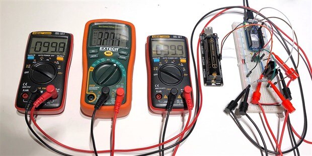

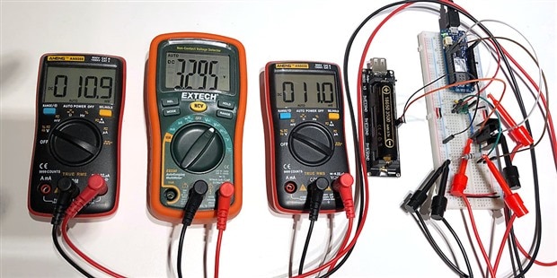

Results
10 mA
DAC output: 10.9 mA
DUT voltage: 3.295 V
Current: 11 mA
Error: 1 mA

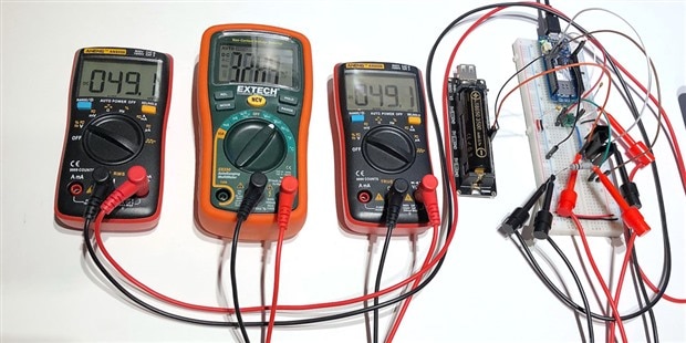

50 mA
DAC output: 49.1 mV
DUT voltage: 3.289 V
Current: 49.1 mA
Error: 0.9 mA
100 mA
DAC output: 99.8 mV
DUT voltage: 3.271 V
Current: 99.1 mA
Error: 0.9 mA

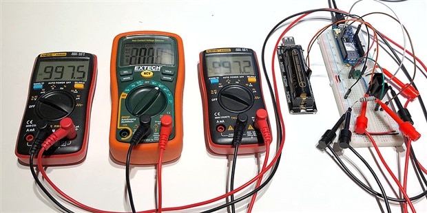

1000 mA
DAC output: 997.5 mV
DUT voltage: 2.89 V
Current: 997.2 mA
Error: 2.8 mA

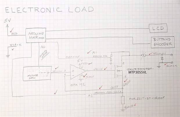

Next Revision
Although the full range was not tested, this was a promising beginning especially since there was no tuning.  Here are a couple of areas to work on for the next iteration:
  • 12 bit or more DAC (this one gives ~ 3 mA resolution)
  • move ADC off board
  • Precision resistor (0.98 ohm 3 watt of unknown tempco was used)
  • Replace MTP3055VLMTP3055VL with a more modern part
  • Add overcurrent and reverse polarity protection
  • Add user interface
  • Add heat sinks / cooling fan

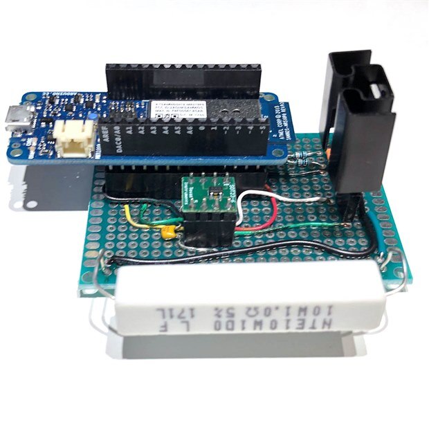

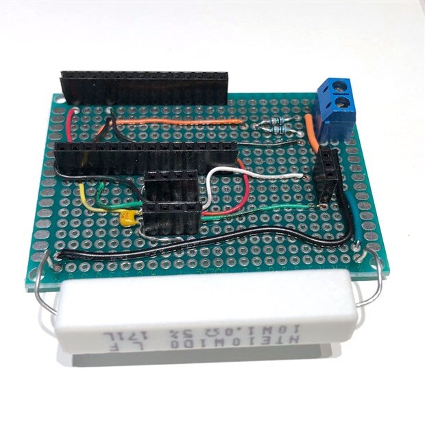

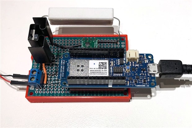

8 July 19 Update
I soldered a little protoboard to play with before deciding what to do next.  The idea was to make something more reliable mechanically and allow some thermal testing and firmware development.  The design still uses the DAC on the Arduino MKR1000 , OPA192 op amp and the MTP3055VLMTP3055VL MOSFET.  The one ohm resistor was picked up cheap locally and measures 1.003 ohms using the milliohm meter.
Female headers were soldered in so that the parts can be easily removed and reused in future.
Here it is populated.
If you have a 3D printer, then you have to print stuff.  Here it is in a little tray.
After fixing a wiring mistake where I confused pin 5 on the op amp with pin 5 on the carrier board (pin 5 on the op amp leads to pin 6 on the carrier) everything was working.  There seems to be an intermittent bad connection between 5V on the MKR1000 and the op amp - one of the main reasons the board was constructed was to avoid this!.  The DAC is accurate in the range tested so far as is A1 which measures the input voltage.  A2 which measures the voltage (and thus current) just above the resistor has about 17 mV offset which seems high but I should consult the datasheet to see if it is in spec.  It can be corrected in firmware.
Next Revision
It may be a while before I get back to this which is why this interim step is being documented.  Thoughts for the next revision...
  • Design a PCB to improve mechanical connections, provide a ground plane, and reduce unwanted capacitance
  • 12 bit or more DAC (MKR1000 has ~ 3 mA resolution with 3A design)
  • move ADC off board (more accuracy, less offset)
  • Precision resistor or at least experiment with tempco of resistor on prototype.
  • Use new Keysight scope with signal generator to investigate issues outlined by Michael Kellett in comments

  • michaelkellett
    michaelkellett over 7 years ago +9
    I expect that with some settings and loads your current sink will oscillate. You'll be able to mitigate this with the following changes: about 47R between op amp output and MOSFET gate 4k7 MOSFET source…

    fmilburn over 7 years ago in reply to michaelkellett +4
    Thanks Michael, It sounds like the issues and approach to resolution will be similar to the milliamp meter. I have not constructed a spice model yet but plan to do so. Frank
