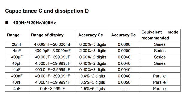

Similar tables are available for other parameters, frequencies, and ranges and another example for impedance is shown below.  The bottom end of the impedance range at 100 Hz is 0.4 ohms, shows 4 digits, and is accurate to 4% + 3 digits.  That is pretty impressive but see my comments on measuring resistors.
One thing I like about the BK Precision 880 is that it can automatically select the recommended equivalent series or parallel mode, a feature not available on the Multicomp Pro which is the kind of thing I am apt to forget to do.  A feature not present on this instrument but available on the others is a DC setting for resistance.  I don't consider that much of an issue for my use.

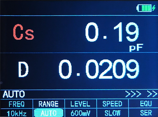

Calibration of the Multicomp Pro takes a few minutes to compete and is done in both open and closed modes.  The meter cycles through all frequencies and ranges.  It must be done in manual mode.

On the 20 mF range the Multicomp Pro specification show capacitance accuracy to be 8.00%+5 digits and all but the M-Tester are within 8% of the Multicomp Pro.  The accuracy of the ESR measurement is not given for the Multicomp Pro but from my tests in my Deep Dive into ESR blog I know that the ESR70 cannot make accurate measurements at 0.04 Ohms and we are down in that region.  The M-Tester does not make accurate ESR measurements in this region.

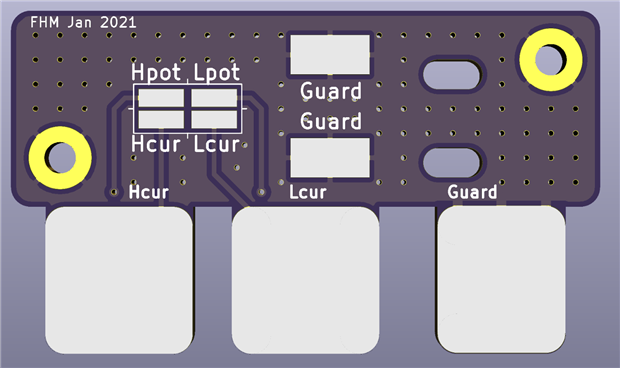

    Incidentally, there's another method that might suit your needs for the kelvin measurements.  If you had a PCB designed that would fit into the slots, then you could have solder points where you can temporarily solder the device-under-test (and then desolder it and use it). The benefit of that over the clamps/clips etc is that nothing moves, so measurements will be as steady (and hopefully as accurate) as possible. Then you could have another PCB with no component, just a short soldered across, and that becomes your short calibrator. You'd also use another PCB for the open calibration. You could even get the contacts gold plated, perhaps that's guilding the lily though : )
    Anyway, it's an option that I think is worth it with LCR measurements.
    I do a similar thing with a vector network analyzer (VNA). This was the PCB I used (It says Texas Instruments on it because I copied chunks of it from their design), and in this case I have to use connectors since the VNA does not have slots. But you can see the idea. In the photo below the component under test is the tantalum capacitor, soldered to the DUT section of the board.
    If you had (say) five boards made up, then two could be dedicated for short and open purposes, and the other three could be used for testing up to three devices without needing to solder/desolder the components so frequently when making comparisons. Or some boards could be soldered with reference components so that you can always double-check that your meter is correctly set up maybe. Your design would also need kelvin traces, in the VNA case this is not possible so I've only got two wires going up to the point where the component or short etc is soldered.

    Here is what I came up with.  The basic design was inspired by one from VoltLog, referenced in the blog above.  I've also added pads based on your suggestion above.
    Top
    Bottom
    Copper
    I can get 3 made at OshPark with ENIG for $16 with shipping, so it is a reasonable cost.  The two holes on the diagonal are for mounting in a 3D case.  The two holes close to each other in the middle are for securing the cable coming in from the Kelvin clamps with small cable ties or wire.  The fingers that slide into the LCR meter are such that it should only go in with the correct orientation.
    My thought is to use one of the PCBs to make the Kelvin Clamps and the other two for testing smaller parts. One could have the pads shorted for calibration.  The other would be calibrated open and then the DUT soldered on for testing.  The Kelvin pads are on standard 0.1" spacing.
    I would appreciate your thoughts on the DUT pads.  The pads lengthwise are 9.7 mm.  The total width top to bottom is 3.75 mm.  I've split the pads lengthwise for 4-wire measurement.  The width between the two split halves top to bottom is 0.25 mm (same width I often use for TSSOP and OshPark can get solder mask in between).  The pad separation in the X direction is 0.7 mm which is what I would use for 0603 parts.  I am interested in you thoughts on the size of this DUT fixture.  I thought about making it bigger but don't want to make it smaller in order to keep the solder mask.

    Those are great suggestions.  I am going to go through them one by one, make some changes, and repost something this evening.  I realize I didn't do a good job of describing the DUT pads so will add dimensions next time.
