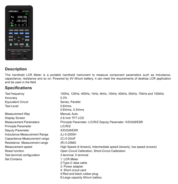

Background
I am constantly trying to upgrade my bench and this is the first really capable LCR meter I have owned.  It was definitely a want as opposed to a need but after winning a Project14 contest a while back I was able to obtain it.  My interests lie in the relatively complex way that passive components can behave and how they differ from ideal behavior.  Among the areas I have investigated out of curiosity are the measurement of resistance in the milliohm region, capacitor ESR, and capacitor variance with frequency.
Two other LCR meters with similar capability often seen are the Der EE DE-5000 and various versions of BK Precision handheld LCR Meters - e.g. the top of the line 880.  These sell for approximately $100 and $330 respectively with lower cost versions of the BK Precision meter available.  I looked at their specifications and read reviews before ordering my Multicomp Pro LCR meter to get an idea of what else is on the market.  Multicomp Pro is a relatively new brand for Farnell / Newark and I only recently came upon this meter.  The current price at Newark is $195.
I wanted a meter with high resolution, good accuracy, multiple test frequencies, 4-wire measurement capability, auto ranging, wide measurement range, and all the measurement parameters you can get on an LCR meter.  I want it all!
Specifications
Credit: specifications from Farnell website: 2899698.pdf (farnell.com)
