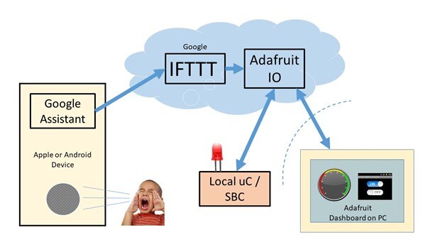

In this blog I intend to outline a reasonably simple way to control Wi-Fi enabled Arduino compatible boards and single board computers like the Raspberry Pi or Beaglebone.  In addition an Apple or Android device that can run the Google Assistant app is needed.
I have been thinking about this for a while and there are a number of approaches.  For example, two Ben Heck episodes Part 1 and Part 2  automated the workbench with voice control using Alexa.  More recently there was a post on Hackaday by igorfonseca83 that automated a robot using the process outlined here.  The approach used by Ben Heck seemed more versatile but the approach on Hackaday seemed easier to implement and I started with that.
Here is how it works...  The user speaks into a tablet or smart phone that is running the Google Assistant app and makes a request - e.g. "Set voltage 3.3" or "Turn coffee pot on".  The request then goes off into the cloud where Google Assistant and If This Then That (IFTTT, a free service) somehow make sense of what you are asking.  Or maybe not.  Assuming IFTTT works as planned a message is sent to the Adafruit IO site which stores it for future use.  An Arduino or Python program can then access Adafruit IO and take action - like setting the voltage on a power supply to 3.3V or turning the coffee pot on.  Or not.  It is also possible to use Adafruit IO to set up a dashboard which can be used for control and reporting but that won't be covered today.
My limited experience with this technology is that it has improved greatly in recent years but errors are still not infrequent.  Most of the write-ups and videos I have seen don't really cover this problem although there are some pretty funny (and not so funny) posts occasionally about the misunderstandings that occur with Siri, Alexa, Google, and the like.  I will report on the issues I encountered at the end of the post.

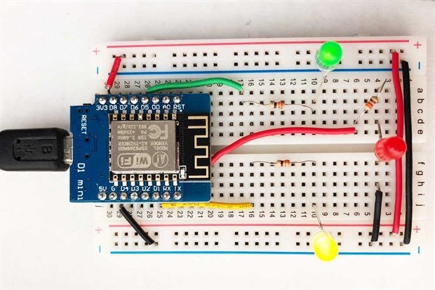

Hardware
As stated above, an Apple or Android device that can run Google Assistant is needed.  Start by signing up for that - I used an Apple iPad and downloaded the app from the app store.
For an end device I am using a D1 mini ESP8266 but the Adafruit libraries are written for Arduino and should work with many more devices.  Adafruit also offer Python libraries for the Raspberry Pi and Beaglebone.  I tried using a Raspberry Pi but had difficulty getting it to work.  Ultimately I would like to use a Pi so that the dashboard on Adafruit IO could also be displayed. To test the physical interface I set up a breadboard with the ESP8266 and attached yellow, green, and red LEDs.

#define RED_PIN           4         // Flags errors in input
#define YELLOW_PIN        5         // PWM (0 to 255) and ON/OFF
#define GREEN_PIN        14         // ON/OFF only

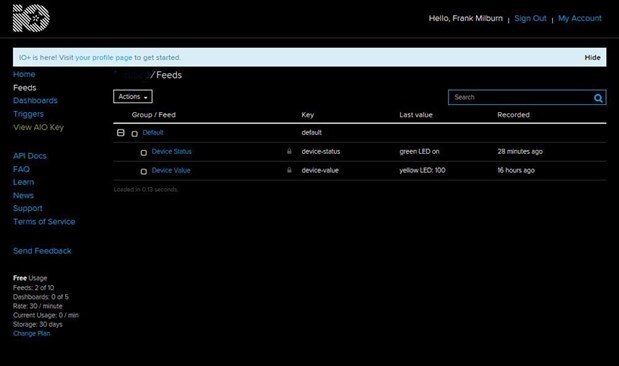

An Adafruit IO account must be set up and the feeds that it will process from IFTTT defined.  I have two feeds that are named device-status and device-value.  They must be present in the sketch and in the Adafruit IO account.  A useful feature of the Adafruit IO site is that the feeds can be monitored as they arrive.
The need for two feeds result from the way that IFTTT works.  In our application, if something happens in Google Assistant where one of four possible triggers is activated then Adafruit IO will be called.  Each trigger is treated as a different feed by Adafruit IO and in this example two triggers are used.

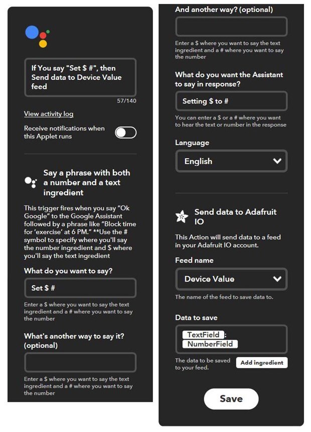

There are four possible types of triggers in IFTTT for Google Assistant:  "say a simple phrase", "say a phrase with a number", "say a phrase with a text ingredient", and "say a phrase with both a number and a text ingredient".  To minimize the number of feeds to Adafruit IO I am using just "say a phrase with a text ingredient" and "say a phrase with both a number and a text ingredient".  They are set up in the following form:
  • "Set $ #" where $ is a text ingredient and # is a variable holding a number - example: "Set YELLOW LED 200" where the underlined phrase is $ and the number 200 is #
  • "Turn $" where $ is a text ingredient - example:  "Turn RED LED ON" where the underlined phrase is $
We could set up more but quite a bit can be done with just these two.  For example it would be possible to define "Set Power Supply Voltage 3.3".  After defining the trigger, the then portion of the construct is defined.  In our case if one of the triggers is activated then we call Adafruit IO with a message (which our end device then grabs while polling).
The following shows the completed "Set $ #" applet.
