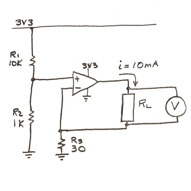

To start, I chose a simple circuit using a single op-amp to create as a current source to see how far it would get me.
The op-am is a  dual rail to rail TLV2462a I had on hand with 500 uV typical input offset voltage.  The supply voltage can be from 2.7 to 6 V single supply so it will work well with batteries and a microcontroller.  The temperature coefficient of the input voltage is 2 uV per degree C so it should be fairly stable.  The second op-amp on the IC may come in handy later.
The remaining circuit components and values were chosen as follows:
  1. 3V3 power rail - this needs to be precise since along with a voltage divider it will set current.  I am using my bench power supply for this test but will use a voltage regulator in a final design.
  2. 0.3 V common mode op-amp input voltage - This was selected as it is well above the lower level for input and output voltage and is also at a convenient level for setting the current.  It provides room between the lower and upper voltage output levels for a range of resistance measurements.
  3. 10K and 1K values for the voltage divider - arbitrary 1% values I had on hand which set the voltage to the non-inverting input of the op-amp at 0.3 V.
  4. 30 ohm current setting resistor - since the non-inverting input is 0.3 V, the op-amp will do it's best to keep the inverting input the same due to op-amp action with negative feedback.  Through Ohms Law the current is 0.3 V / 30 ohms = 10 mA.

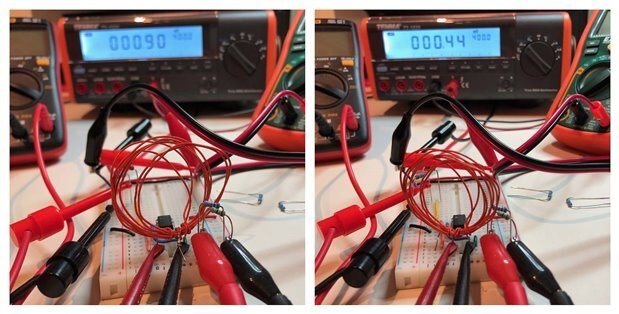

Power comes in from the left out of my bench power supply and is supplied to the rails of the op-amp.  The resistors for the voltage divider can be seen lower left on the breadboard and feed the non-inverting input through the yellow wire.  I measured the voltage at 300.3 mV.  The salmon / pink colored wire is the output and goes to the DUT - a coil of orange wire.  The blue wire leads to the inverting input.  I did not have a 30 ohm 1% resistor and used 33 ohm and 330 ohm in parallel instead (measured resistance of 30.04 ohms).  Since the measured voltage across the current setting resistors was 300.5 mV and the measured resistance was 30.04 ohms the current is as close to 10 mA as I can get with my equipment.  The multimeter readings are steady.
Testing
I tested a range of 1% resistor values I had on hand from 30 ohms down to 1 ohm.  All were within the accuracy of the resistors and matched my multimeter well.  I followed the example of Shabaz and used wire for the final test.  I believe it to be 26 AWG telephone wire and it is approximately 1 meter in length.  I "center tapped" it so that I could measure from end point to end point or from the center to either end point.  The following photo shows the results:
The left photo reads 0.90 millivolts across the entire coil of wire.  Since the current is 10 mA the measured resistance is 0.090 ohms.  In the picture on the right the center tap to right end is being measured at 0.44 millivolts which is a resistance of 0.044 ohms where we expect 0.045 ohms.  I got identical results using the other end of the wire and the center tap.
I also measured the resistance of the wire using the multimeter.  When the leads are shorted together the meter reads 0.09 ohms.  On the center tap to end measurement the meter reads 0.20 ohms so if I back out the leads I get 0.11 ohms which is more than twice what was measured using the Kelvin method and the current source.  The spec sheet states that the meter has 0.01 ohm resolution with accuracy +/-(0.3%+40)+test leads open circuit value when the range is 400 ohms.
