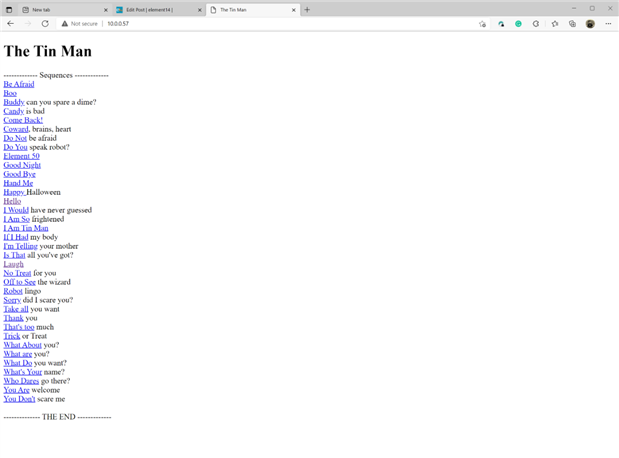

The code that sequences the voice and servos was modified to play loops and a simple WiFi web page set up for control.
I'll post that code if anyone wants it but it is similar to what I've done before and described for Bender although I am trying to clean it up a bit and may post an improved version at some point.
