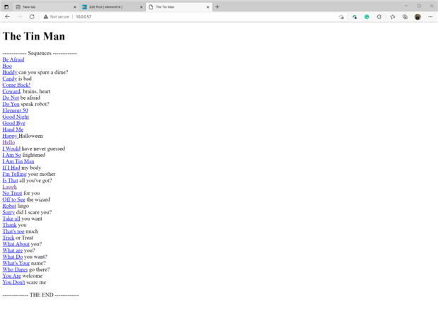

The code that sequences the voice and servos was modified to play loops and a simple WiFi web page set up for control.
