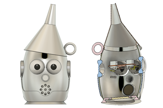

The Tin Man is now mechanically and electrically complete.
Printed Parts
I didn't take any photographs during assembly but it was straightforward.  The front and sectional view from the back below shows the parts minus the electronics.

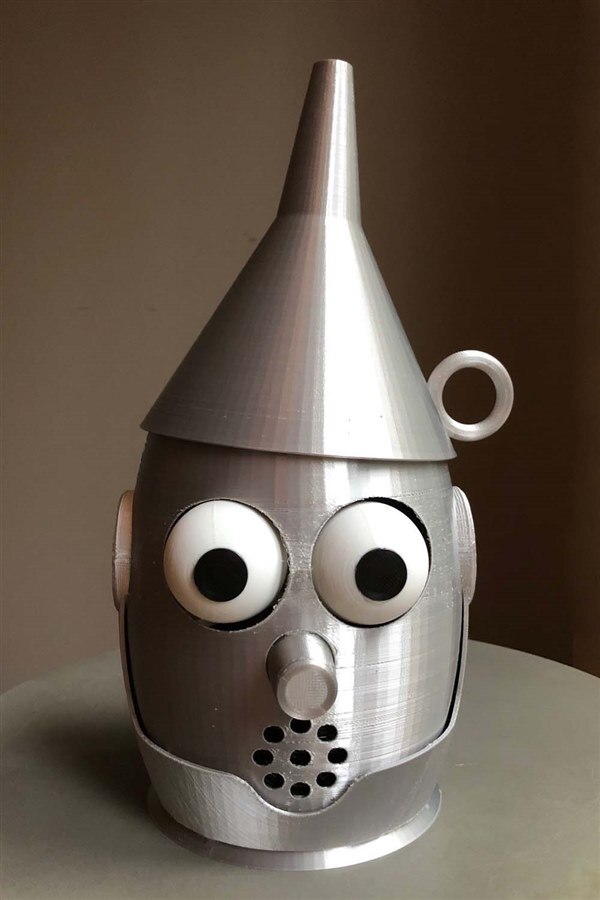

Here are my comments on the outcome:
  • Appearance:  The appearance differs from the model, at least to me.  As printed, he looks thinner and the gap between the eyes and the shell is more prominent.
  • Print Quality:  As noted previously, print quality is not that great and is most apparent on the face.  I think that is due to the thin (1.6mm) shell and the orientation which shook the print as the filament was laid down.
  • Eye Movement: Eye movement has been improved by tightening up the tolerances and slop in the joints.  I have several ideas for improving this further.
  • Assembly:  The nose cap, eye irises, base plate, and funnel cap handle were glued on with epoxy.  The eye assembly and bottom entry panel are screwed in using heat-set inserts.

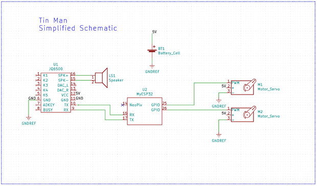

A connection for a future "Neopixel" string was tested and added to the schematic but otherwise, it is unchanged.  The battery shown is a 18650 and resides in a power circuit with charging capability, boost to 5V, and 3V3 LDO regulator (not shown).  The ESP32 can be powered from the 3V3 output of the power circuit.

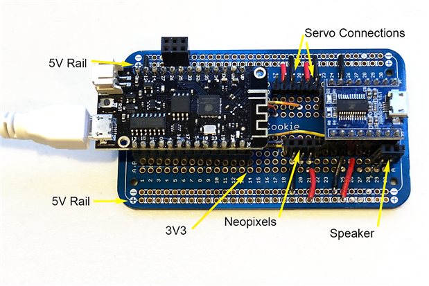

The circuit was then transferred from a breadboard to a prototyping board with the connections shown below.
I essentially use this arrangement in all my animatronic projects and it would probably be worth having a PCB made and standardizing on a microcontroller and sound chip.
