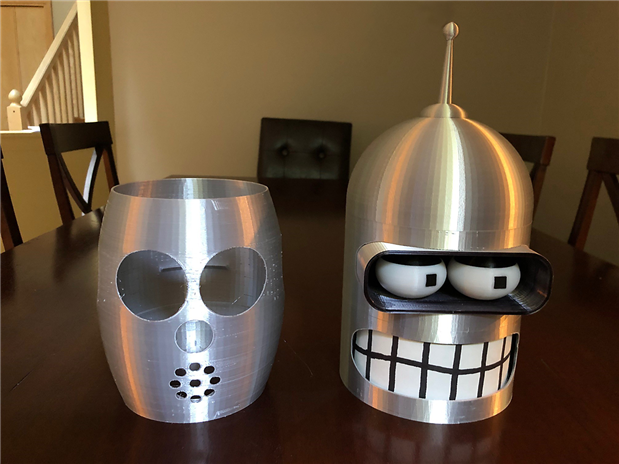

Last week I started a series of blogs on making the Tin Man from the 1939 movie The Wizard of Oz.  The progress towards completion has been leisurely but this week's update features the first 3D print and code to add speech and smoothed movement to the eyes.  I also showed the Tin Man to Bender who does not seem happy about a new robot in the house.

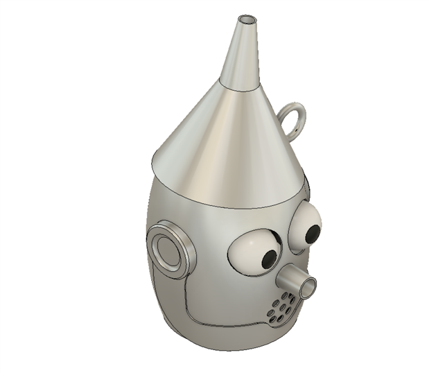

As a reminder, this is what he will ultimately look like.  I hope.

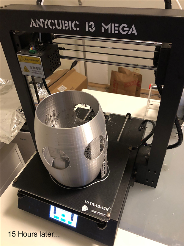

The shell of the head was started last night around 8:00 PM and after a bit more than fifteen hours later it was complete.

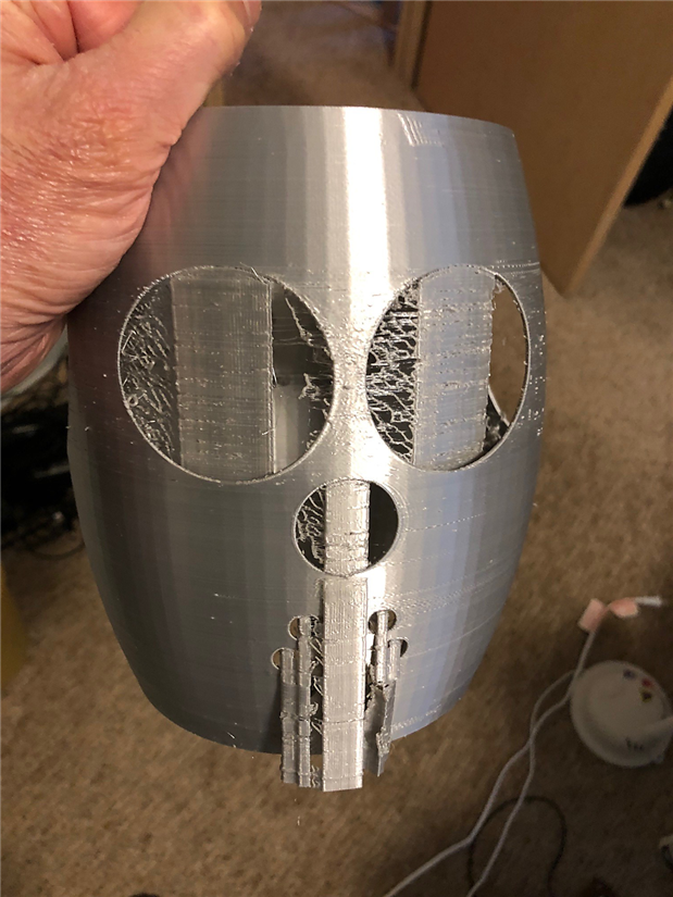

I learned a number of things from this print.  It was as large as anything I've printed and the shell was only 1.6mm thick.  Normally, I print thin shells at 2.0mm. I considered printing this without supports based on previous comments by Douglas Wong on the ability of PLA to bridge gaps.  In the end, I elected to add supports thinking it would increase the probability of success and not wanting to lose the print.  Adding supports increased the print time by 3 hours.  Among the things learned:
  • One support failed completely (left ear) and one became very distorted (right ear)
  • The opening with the failed support bridged OK even without support
  • The poor supports occurred along the Y-axis where the print table bangs back and forth
  • There was a lot of stringing, especially where the supports failed
If I were to reprint this I would do it without supports.  Here is the view from the front where the supports worked as designed and prior to removing supports and stringing.  This would make a pretty scary Halloween mask.

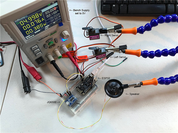

For now, a bench power supply is used to power the JQ6500 for sound and the two servos that control the eyes.  In the final build, this will be replaced by a 18650 battery with a power management system.  The actual test setup is shown in the image below.

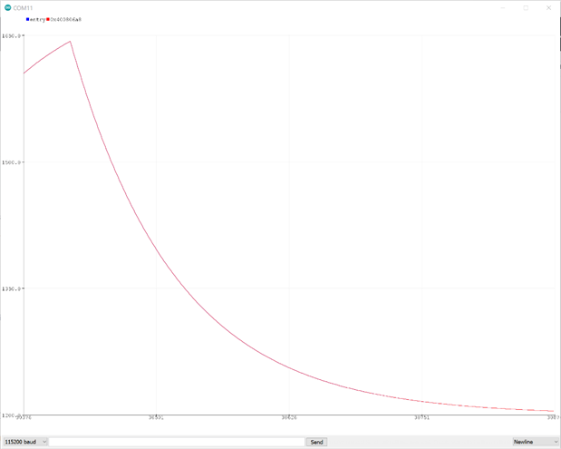

The standard Arduino servo library moves the servo from the starting position to the finishing position as fast as the servo will turn.  The algorithm by Bruton starts the servo out fast and then slows it as it approaches the final position in an attempt to make movement smoother and more natural.  In the plot below I've plotted the output of one such event using the Arduino plotter.
Note that if the movement hasn't finished (the sharp peak at the start of the plot) then a call for a new event will start immediately anyways in the algorithm as I have implemented it.
