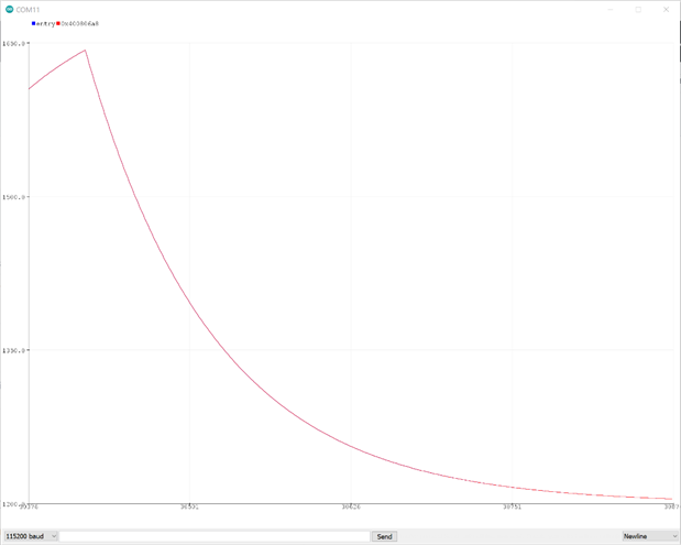

I plan an upgrade to the animatronics over what was done with Bender by creating a sequencer. The sequencer will execute events like controlling the eyes and speech at pre-selected times.  The speech events will be done using the Arduino library for the JQ6500 by James Sleeman located here.  The algorithm described by James Bruton located here will be used to smooth out the movement of the servos events.  Modifications were made to the libraries and algorithm to work with the ESP32 and suit the needs of this project.
The standard Arduino servo library moves the servo from the starting position to the finishing position as fast as the servo will turn.  The algorithm by Bruton starts the servo out fast and then slows it as it approaches the final position in an attempt to make movement smoother and more natural.  In the plot below I've plotted the output of one such event using the Arduino plotter.
Note that if the movement hasn't finished (the sharp peak at the start of the plot) then a call for a new event will start immediately anyways in the algorithm as I have implemented it.
