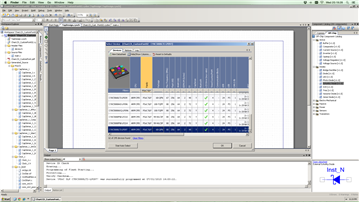

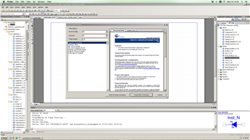

Rather than starting from scratch and having to figure out every aspect of controlling a character LCD, it's possible to load an example, try to understand the example, verify it works and start making modifications to it.
To load the example workspace, go to "File > Example Project ...". In the popup, enter "LCD" as a search criteria for project name. This should leave a few projects to pick from. Pick "CharLCD_CustomFont".
Finally, once the project is loaded, right-click the project name and select "Device Selector ...". In the popup, make sure to select the device that matches yours.
You can then proceed to build the project and program your device.

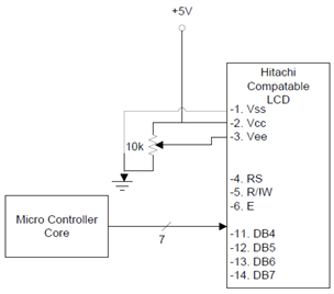

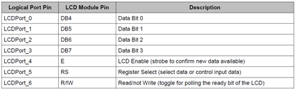

Connections
The connections required for the LCD are specified in the datasheet, which can be accessed by right-clicking the "Character LCD" component and selecting "Open Datasheet ...".

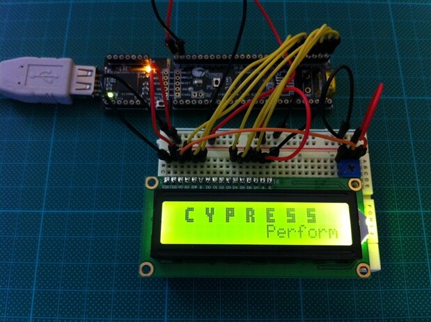

Test
If the kit was programmed successfully and the connections to the LCD are correct, the following should appear:
The top row are a bunch of custom characters spelling out the word "CYPRESS", the bottom row is the string "Perform".
The custom characters can be modified by double-clicking the "Character LCD" component in the TopDesign.

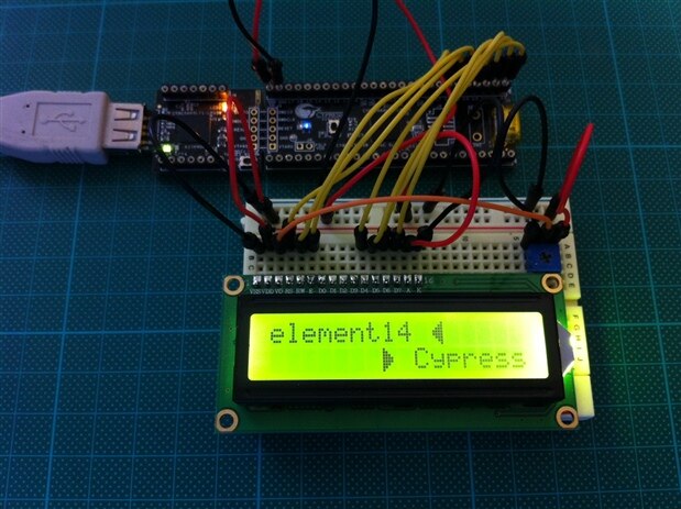

Modifications
Once the sample code is working properly, it is of course possible to modify it.
My first modification was to display two different strings statically, including two custom characters. This is the code:
#include <device.h>
extern uint8 const CYCODE LCD_customFonts[];
void main() {
  LCD_Start();
  LCD_LoadCustomFonts(LCD_customFonts);
  LCD_Position(0u, 0u); // first row, first position
  LCD_PrintString("element14");
  LCD_Position(1u, 9u); // second row, ninth position
  LCD_PrintString("Cypress");
  LCD_Position(0u, 10u);
  LCD_PutChar(LCD_CUSTOM_1);
  LCD_Position(1u, 7u);
  LCD_PutChar(LCD_CUSTOM_0);
  CyDelay(200u);
  for(;;) {}
And the result:
The previous modification is static. it displays the strings of text and leaves them as is.
