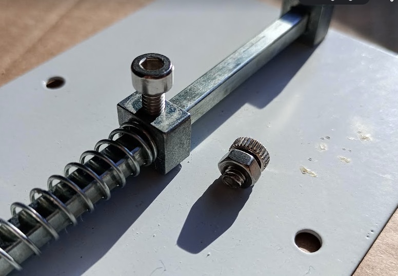

Recently I completed a cleanup of my soldering station ( Solder Station Cleanup and Organization Project).  When I was in the process of setting up my workspace, I found a very low-profile board holder that I thought would work great in my new space.
I really like the easy loading of a PCB, simply pull back the spring-loaded clip and drop the PCB in and release the spring.  The thing that I disliked the most about this particular board holder was the knurled knob that secured the spring tensioner.  The darn thing was so tiny I could not apply sufficient torque to actually tighten the screw in place.  The above images show a replacement screw that I found with a hex head hole that I could use an Allen wrench to tighten, which was a huge step forward, but still somewhat concerning as it requires having the correct wrench nearby at all times.
So, I looked around for yet another solution, finally finding the right screw/knob on eBay.
The first screw in each image is the original screw, while the second is the hex head version and finally the third is the eBay find.

    genebren over 2 years ago in reply to scottiebabe
    Looking better already.  The hex or Allen bolt was a huge improvement for mine.

  • scottiebabe
    scottiebabe over 2 years ago in reply to genebren
    I didn't realize the thumb screw had an M4 thread size, perhaps I can make a better thumb screw like yours...
