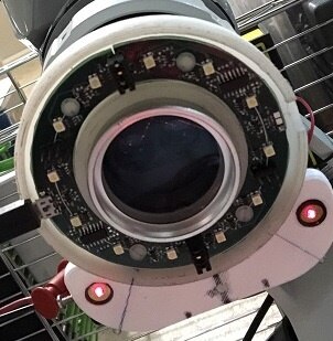

The LEDs are distributed throughout the ring, one LED approximately every 30 degrees.  The two ring halves are connected together at both ends of the rings using a 4-pin header on side of the break with jumper plugs.  Here is a picture of the assembled light ring attached to the microscope (shot from below the ring):
When I started this project, one of my goals was to be able to create different lighting patterns that could be used to increase the detail observable under my the microscope.  In my early experience using this microscope for soldering, I noticed that the positioning of my illumination source (early on a simple halogen goose-neck lamp) made be differences in the image detail and quality.  Sometimes the direct downward light washed out a lot of detail (like the markings on the chips), while a side angled light created shadows and made it difficult to see some of the pins on the chips.  In addition to soldering, one of the uses of my microscope was viewing coins.  In coins, where there are more textures, the side lighting did a great job of enhancing detail and/or scratches by creating shadows.  From these observations, I knew that I wanted to be able to create several different lighting patterns and the ability to rotate these patterns through 360 degrees.
