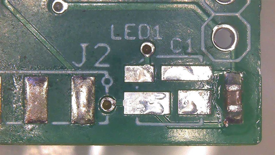

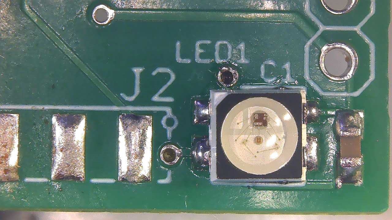

With my devices sent off to my client, I noticed that I had one of these same boards from a prior build that had failed, but I had not diagnosed or attempted to repair the module.  A quick ohming of the contacts on the LED revealed that there was a short from the input to ground as the result of a solder bridge or a mis-aligned part.  The plan quickly formed to use the FNIRSI to de-soldering the part and soldering a new component in place. Here is a short video of the de-soldering process:

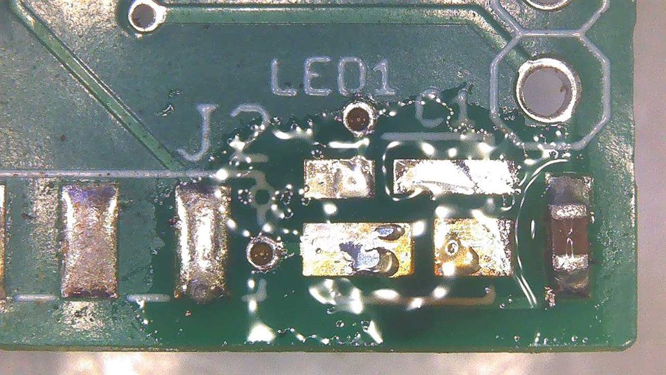

With the part removed, there was a bit of excess solder on the pads for mounting the NeoPixel. Here are before and after pictures of the pads:

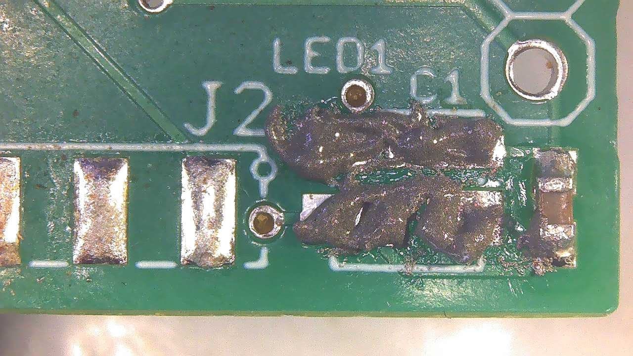

The next step was to apply some solder paste to the NeoPixel pads. This is in no means a clean approach.  I just smeared on some paste to each of the pads.
Next, I placed the new NeoPixel onto the solder paste:
I then soldered the new part to the board, as shown in the following video:

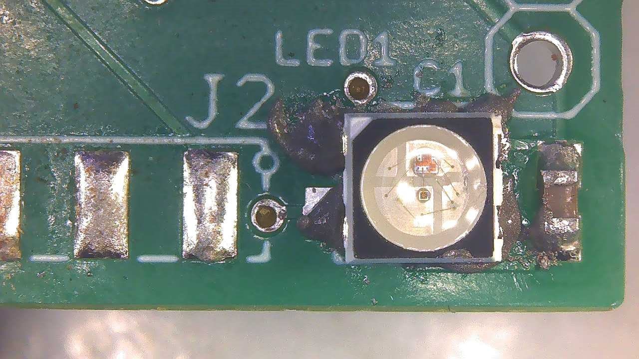

After soldering the part into place, I did a quick cleanup of the part (see below).  While not apparent in the image, it seems as if some residual solder on the pads (from the original hand soldering), might not have melted enough to flow with the hot air, has caused the LED not to have settled flat on the board. As a result, the LED is slightly tilted (left hand side slightly lifted).  Next time, I might need to clear the pads better.

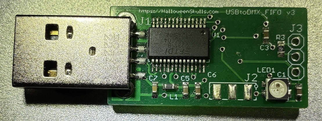

The board that I was working on is a USB to DMX adapter that I build for a client who uses them for Halloween props. This board (shown below) is a USB device, using the FT245R chip for the USB interface.  This device has a bidirectional FIFO interface that facilitates a simple and clean USB read and write process.  An ATtiny3226 chip interfaces to the FT245R to receive and send packets from/to the connect PC. The board also contains a RS422/485 transceiver as a DMX transceiver and a NeoPixel RGB LED.
This board is an example of how I use an LED to help me diagnose/debug a board (see dougw post, "As a designer, how do you make choices?") as well as to show activity to the user. Coding in 'C' it takes about 18 lines of code (most of that is ASM instructs to set a port bit, clear a port bit or NOP to wait) to send the serial string to the NeoPixel, which I do with a bit-banged IO port (pin).  There is an additional overhead to build the string, which is 3 lines of code for each color intensity change.  The programming string is 24 bits, for the 3 LED intensities, GRB ordering, 8 bits each. The timing is pretty critical, so the code must run with interrupts off (or at least make sure that the code can run without being interrupted).  A 'zero' is .2 to .4 us high time, while a 'one' is .58 to 1.0 us.
In diagnostic mode, I can change the color of the LED to indicate the various events occur and/or certain areas of the code are reached.  I can use the NeoPixel programming string as a scope input, along with other board signal to help debug board function.  In operational mode, the LED can be used to show state and activity.
This device utilizes a custom bootloader software package to facilitate firmware updates. If the board is in the bootloader mode, the LED is steady blue. During firmware updates the LED toggles between Green and Off to indicate good programming packets and steady Red if a bad programming packet is received. When the device is operating in the DMX App mode, the LED toggles between Green and Yellow to indicate activity and various packet error conditions.

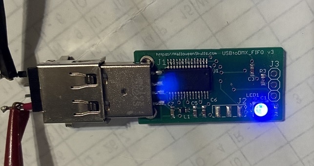

Here is an image of the repaired board, powered up during a quick current check using a current limited power supply to power the board.  The board is in the bootloader mode (steady Blue LED), as I removed this board from the lot, and replaced with a freshly built board. I will need to finish the bring up procedure on this board (configuring the USB part and download the DMX app on to it) before putting this part into service.
