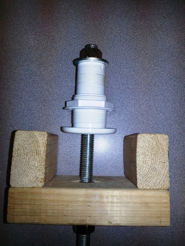

    mcb1 over 8 years ago in reply to shabaz
    shabaz
    I suspect you can remove these ... with a bit of persuasion.
    I'd try drilling and taping into the resin in a couple of places at one end.
    Screw in a couple of threaded rods and fit a u shaped Ie a piece of wood with a slot, over the led strip.
    You should be able to tighten on the thread and effectively wind it out by breaking the glue.
    The image below is the best I could find ... yes it's not great. Most pullers pull the outer section over the inner item.
    http://3.bp.blogspot.com/-ADkTFQTXnaE/U0M4agpJP3I/AAAAAAAAHCs/BcRmLhvwRBc/s1600/2014-04-07+19.33.57.jpg
    Imagine that the threaded rod is much smaller and the white plastic is your LED strip.
    The other option is to remove the cabinet and route them out, or at least route the middle effectively splitting them.
    You can replace them and use double sided tape this time image
    I'd be inclined to leave an air gap so any heat can dissipate, or simply use a strip of acrylic flush with the cabinet base and have the LED strip in behind it.
