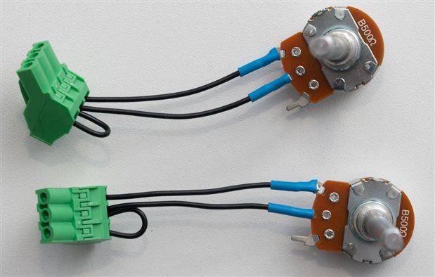

Lucky for me, the DAS240-BAT supports direct measurement of resistance as it has an internal bias generator and the unit is capable of plotting in X-Y mode. All I have to do is supply the resistance.

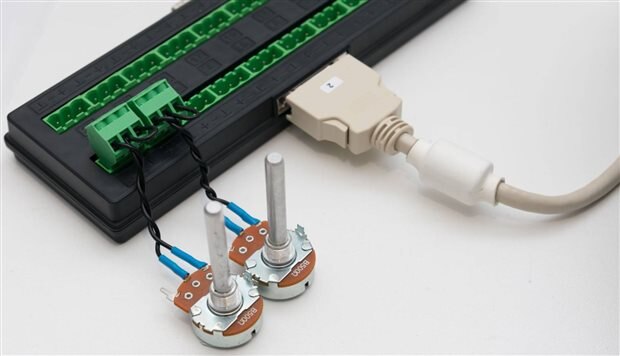

Rummaging in my junk box, I found two new 500-ohm linear carbon-track long-stem potentiometers. I soldered a wire to one end of the track and the wiper and covered the connection in heatshrink. I then wired it to the input pluggable terminal block with the resistance across the +/- connections and the bias tied into the negative side as instructed by the manual.
I twisted the wires for some noise suppression, while plugging it into the 20-channel input module. Using some Blu-Tack, I stuck the potentiometers down to the table so they could be manipulated safely and then grabbed the camera.

    You're right - on a short length, it's not likely they will pick up that much noise, but I suppose it looks a little neater to have them twisted. I suppose I don't really lose anything, since the bandwidth of the chart recorder is (at most) 500Hz, so it's not too big of a consideration either way.

    The wire run on the pots is so short, I'm curious if you get any noise cancellation benefits?
