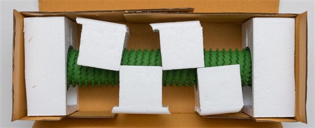

I turned to element14’s shop for a quick fix in the form of the TE Connectivity/CGS TE750B1R0JTE750B1R0J 1Ω 750W-rated chassis-mount wire-wound resistor (Order Code 1760835). Luckily for me, it was in stock in an overseas warehouse, so it would arrive in just a week, but it would cost me AU$80 or so. I thought it was only fair that having been selected for the RoadTest that I go the extra mile. With its 1Ω nominal resistance, I would expect to run it at 27.386V at 27.386A, which should be on the envelope for the QPX750SP, while varying the voltage would allow me to sweep the load on the supply (at the cost of changing the operating voltage point). This is not ideal but with my Tektronix PA1000 Power Analyser, it would be possible to determine conversion efficiency, power dissipated and power factor of the QPX750SP.
Unboxing the #SpicyBar

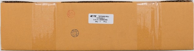

Inspired by the #spicypillow hashtag of late, I think it’s only fair to call this one a #SpicyBar. It arrived in a yellowish cardboard box, lot number 20090455 dated Boxing Day (26th December) 2020. Someone must have been working extra hard! Inside, the resistor was packaged in Styrofoam to keep it safe, all the way from the UK warehouse.

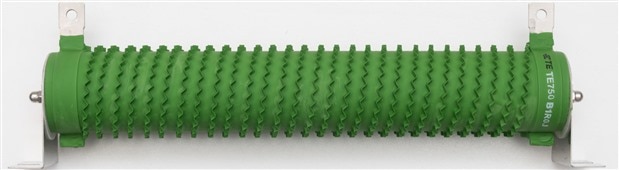

The unit consists of a corrugated band wound around a ceramic former and terminated to lugs at both ends. The whole assembly is coated in green Mullite for protection to maintain stability and longevity. The cylinder core is attached to mounting lugs which are designed to mount to a chassis.
I reused the crimped 6mm2 wire I had from the earlier MOSFET tests and bolted them to the lugs. To ensure safety, I decided to put the resistor on top of a terracotta tile to shield my furniture from the immense heat that it is likely to generate. With that, I wrote a script that would step the voltage up, millivolt-by-millivolt, recording the voltage and current delivered to the resistor (in two wire mode, as wire loss is counted as delivered power) and the power consumed by the power supply from the mains. The process took a while, and I watched on to ensure safety.

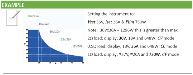

Initial fooling about on the front panel seemed to reveal that the power supply was limiting itself into Constant Power (CP) mode despite not reaching 750W.
I was not expecting this, so I enquired with the manufacturer to find out what was happening, as I wasn’t getting more than about 707W. It was noted that the PowerFlex+ curve is only guaranteed at the points they have indicated and in-between these points, “up to” 750W is available, with no indication of how the interpolation between points is done.
While this explanation definitely makes sense, this was not my expectation based on their marketing material that said “limited by the power curve” on the front of the brochure, which had me thinking it would be able to deliver 750W as long as we don’t violate the maximum voltage and current capabilities. I guess this experiment was definitely important to learn something about the unit.

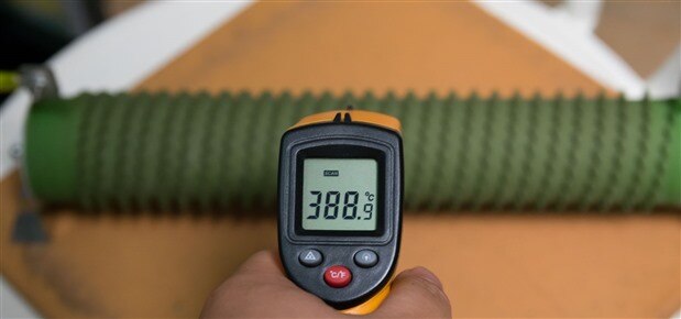

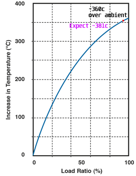

As the test continued, I heard a loud “clunk” from the gear. It turns out my terracotta tile had blistered underneath the resistor, perhaps because of trapped water or latent defects. It didn’t crack entirely, so I left the experiment to continue. In the end, the resistor surface seemed to look a bit more dull and brown due to surface emission, with a temperature almost 389°C. Checking with the datasheet, given the load, it was expected to be 360°C over ambient for about 381°C surface temperature. Given the measurement error of an uncalibrated infrared thermometer, I think this is a great confirmation of the power being dissipated.

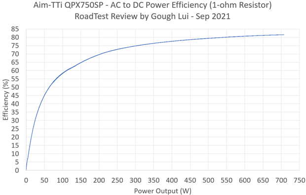

Computing the efficiency versus power delivered shows that with a 1Ω load, an efficiency of 50% or greater is only reached for loads of about 60W or more. An efficiency of 60% is reached by a load of about 110W; 70% for a load of 205W; 80% for a load of 550W. At maximum loading of 707W, the peak efficiency was about 81% which is not bad.

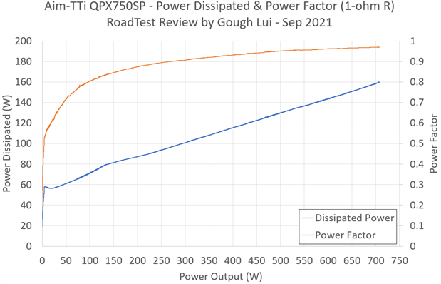

The acoustic behaviour of the QPX750SP can be explained quite easily by looking at the dissipated power curve. The power supply dissipates close to 60W even at light loads into the 1Ω resistor, likely because of the need to deliver lower voltages which come with an efficiency penalty. As the load increases, the dissipated load increases nearly linearly but at a limited pace, reaching a dissipation of 160W at 707W, or about the same as a mid-range desktop computer under load.
Power factor is not bad, eclipsing 0.5 almost immediately under load and staying above 0.8 for a load of 100W or greater. This is not unexpected for a high-power power supply, as this is necessary to ensure compliance with EU regulations and to ensure the limited power available from a single power outlet can be efficiently used. This power supply appears to employ active PFC which is noted in the Teardown chapter.

    As for the power rating discrepancy - it was explained to me that the PowerFlex+ curve is only guaranteed at a few listed points but the interpolation function is not clearly documented between these points. The manual did estimate 720W available under this test situation but I didn't even achieve that:
    I did request the manufacturer clarify the peak discrepancy between the ideal power curve and achievable output or indicate the interpolation function used to ensure users close to the power envelope do not run into a shortfall.
