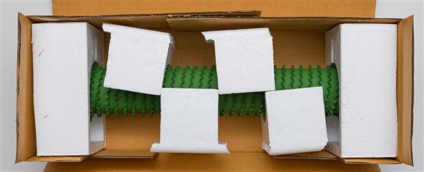

I turned to element14’s shop for a quick fix in the form of the TE Connectivity/CGS TE750B1R0JTE750B1R0J 1Ω 750W-rated chassis-mount wire-wound resistor (Order Code 1760835). Luckily for me, it was in stock in an overseas warehouse, so it would arrive in just a week, but it would cost me AU$80 or so. I thought it was only fair that having been selected for the RoadTest that I go the extra mile. With its 1Ω nominal resistance, I would expect to run it at 27.386V at 27.386A, which should be on the envelope for the QPX750SP, while varying the voltage would allow me to sweep the load on the supply (at the cost of changing the operating voltage point). This is not ideal but with my Tektronix PA1000 Power Analyser, it would be possible to determine conversion efficiency, power dissipated and power factor of the QPX750SP.
Unboxing the #SpicyBar
Inspired by the #spicypillow hashtag of late, I think it’s only fair to call this one a #SpicyBar. It arrived in a yellowish cardboard box, lot number 20090455 dated Boxing Day (26th December) 2020. Someone must have been working extra hard! Inside, the resistor was packaged in Styrofoam to keep it safe, all the way from the UK warehouse.
The unit consists of a corrugated band wound around a ceramic former and terminated to lugs at both ends. The whole assembly is coated in green Mullite for protection to maintain stability and longevity. The cylinder core is attached to mounting lugs which are designed to mount to a chassis.
