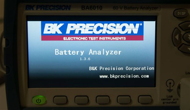

Testing of the BA6010 was done with the device running the supplied V.1.3.6 firmware. No firmware updates were available online at the time this review was conducted.

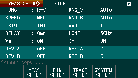

Device parameters are set through the setup menus, of which four are available by pressing the SETUP key followed by the corresponding soft-key underneath the display.
The default set-up screen is the Measurement setup menu. This is probably the most useful menu, as it allows for most of the measurement parameters to be configured, including the measurement function, speed, ranges, trigger sources, averaging, delay, line frequency, display of measurement parameters and deviation display. Using this menu is not always necessary – on the Measurement display, using the cursor keys and soft-keys allow the function, speed and ranges to be altered directly.

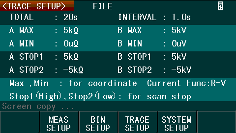

The Trace setup menu allows for configuration of the parameters used for the trace display mode. Unfortunately, it seems this mode is rather limited, requiring pre-configuration of the maximum and minimum values for each of the measured parameters and total record lengths/intervals prior to use. Redefining these values after a collection has started seems to reset the collected trace data. The trace mode also allows for configuration of value “boundaries” which will stop the trace scan feature.

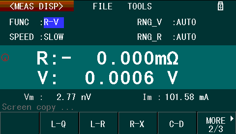

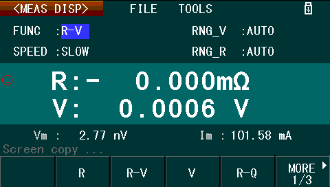

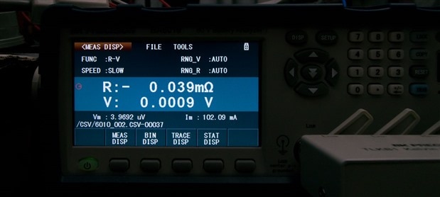

The measurement display is the main display you would use when interactively using the device. This mode resembles the display you might expect to see on a benchtop multimeter, showing the measurement parameters and measurement values.
As noted earlier, it is possible to change some measurement parameters directly through using the cursor keys within the measurement display. For example, here, we are toggling through the three soft-menus of measurement modes available (in the bottom line).
For example of a basic measurement, here is a basic resistance and voltage measurement of a completely sulfated sealed lead-acid battery.

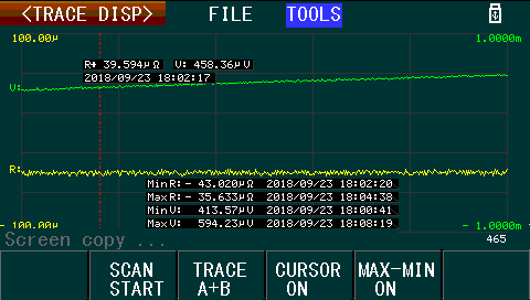

The trace display allows for monitoring values as they change over time. Provided appropriate limits have been configured in the Trace setup menu, the scan can be started from the Trace display. A cursor and Max-Min data display are available.
Unfortunately, this mode is rather limited in its functionality as the horizontal scaling is fixed to a certain number of points across. For longer captures, to see all the data requires cursoring through the readings one value at a time using the navigational keys, which is quite slow. If the scale of the graph is not correctly set prior to starting the scan, then the plot will not be useful as changing the parameters post-capture seems to reset the plot.
I have noticed that on very long traces, the screen does occasionally flicker some illegible text in the bottom left corner, which suggests some kind of possible firmware bug.

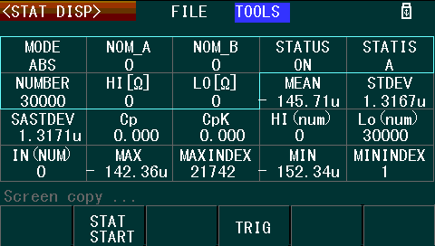

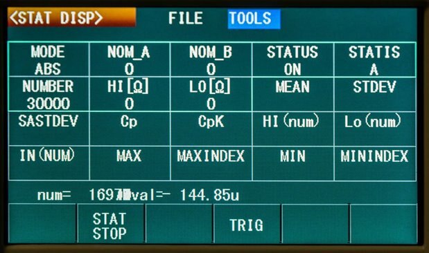

The statistics mode deviates from the other modes in that the statistical parameters are set within the statistics display itself rather than through a dedicated settings page. Up to 30,000 readings can be used for the in-built statistical calculations, with the possibility for manual triggering. In my experience, while the mode did work and could be of use in standalone use, if a PC were available, directly analysing the raw data over the remote-control interfaces may prove more instructive.
Like with the trace mode, it seems that long captures cause graphical glitches on the screen as well, suggesting the firmware lacks some polish.

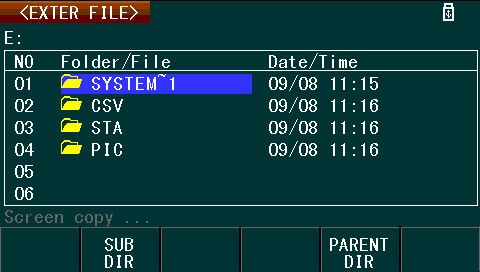

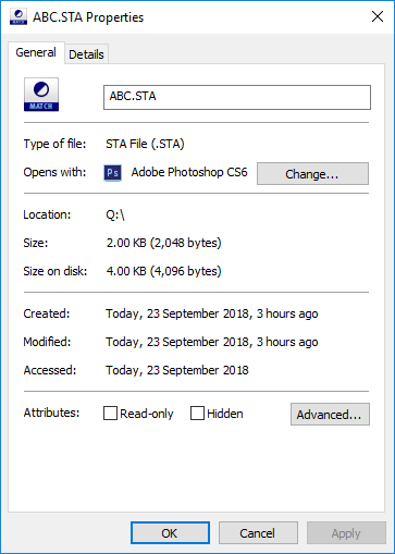

The BA6010’s front panel USB host port allows for the use of USB flash memory for the exporting and saving of screenshots, CSV data logs and instrument settings. This is in addition to a limited amount of onboard instrument settings memory.
Instrument settings are saved as .STA files of 2048 bytes in length. This can be copied from the internal memory to the USB drive from the BA6010’s interface. Instrument settings can be restored through the interface and seem to consist of raw instrument binary configuration memory.

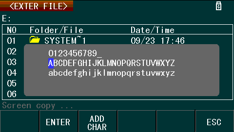

File locations and names can be chosen through the interface, however, using the on-screen keyboard can be somewhat frustrating due to its layout.
In measurement mode, measured data can be recorded to an automatically named .CSV file as well, displaying the name and sample number on-screen during recording.
It was observed, however, that on longer recordings that the unit would “pause” as data was flushed to USB resulting in gaps in the recorded samples. This limits the usefulness of this feature, especially at higher sample rates.
Screenshots can also be taken to external USB memory by the use of the “COPY” button on the front panel. This results in the screen being captured to a .GIF file, stored within the /PIC subdirectory of the USB drive. Unfortunately, each captured screenshot has the “Screen copy …” text obscuring any data present on the status line.
One limitation is that the BA6010 works with only FAT/FAT32 drives and cannot handle drives with too many files already stored on the drive. I have encountered situations where the drive “hung” the BA6010 during detection requiring a power cycle, so I recommend using a fresh small-capacity USB drive for dedicated use with the BA6010. I have also encountered situations where the first screenshot on a fresh USB drive was recorded as “zero bytes” despite showing that the screen copy had been completed and the analyser shut down using the front power button before removal. As a result, it might be a good idea to take “vital” screenshots twice.

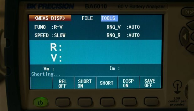

Measurement of low resistances requires more than just Kelvin connections, as there are also other sources of error such as thermal EMFs which can develop at the interface of dissimilar metals – an effect exploited by thermocouples. To ensure the highest measurement accuracy, the BA6010 is capable of nulling out the zero-resistance point by performing a calibration procedure with the clips shorted together.
Rather humorously, this procedure is referred to as “Shorting …” by the analyser, but rest assured, nothing bad is happening. Although if you fail to arrange the clips to minimise their resistance for the shorting procedure, you may inadvertently introduce error into the measurement – so be sure to complete it as instructed after the instrument has warmed up and leave the “Short” compensation mode switched on for the highest accuracy.
