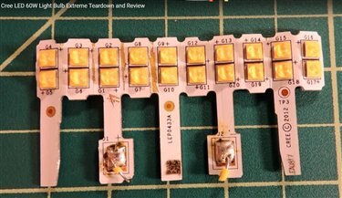

    shabaz over 10 years ago in reply to Gough Lui
    Yeah I agree, things could change over time (I don't really know enough about Vf behaviour over time). It is interesting though that even well-known brands seem to do this, e.g. this Cree lamp teardown shows no resistors in sight, and apparently this is two parallel strings:
    Given that every engineer knows (or should know!) about Vf and the variation of it, I suspect it is highly likely that the binning goes on (for reputable manufacturers at least), else it doesn't explain why so many different manufacturers do this practice.
    Probably this is just for consumer lamps though, they can afford more exotic circuits for industrial lamps I guess.
    You're right that we just don't know about the quality and binning as part of that, since failures take quite a while to occur.
    Also, as a digression, Cree has some high-end lamps too, which have clever tricks to make sure the light looks "nice" for (say) cosmetics counters etc. Some of their lamps have white and red LEDs, and the brightness of the red LEDs are adjusted over time as the lamp warms up, to compensate for the changes in color that occur by using the phosphor method for white LEDs.
