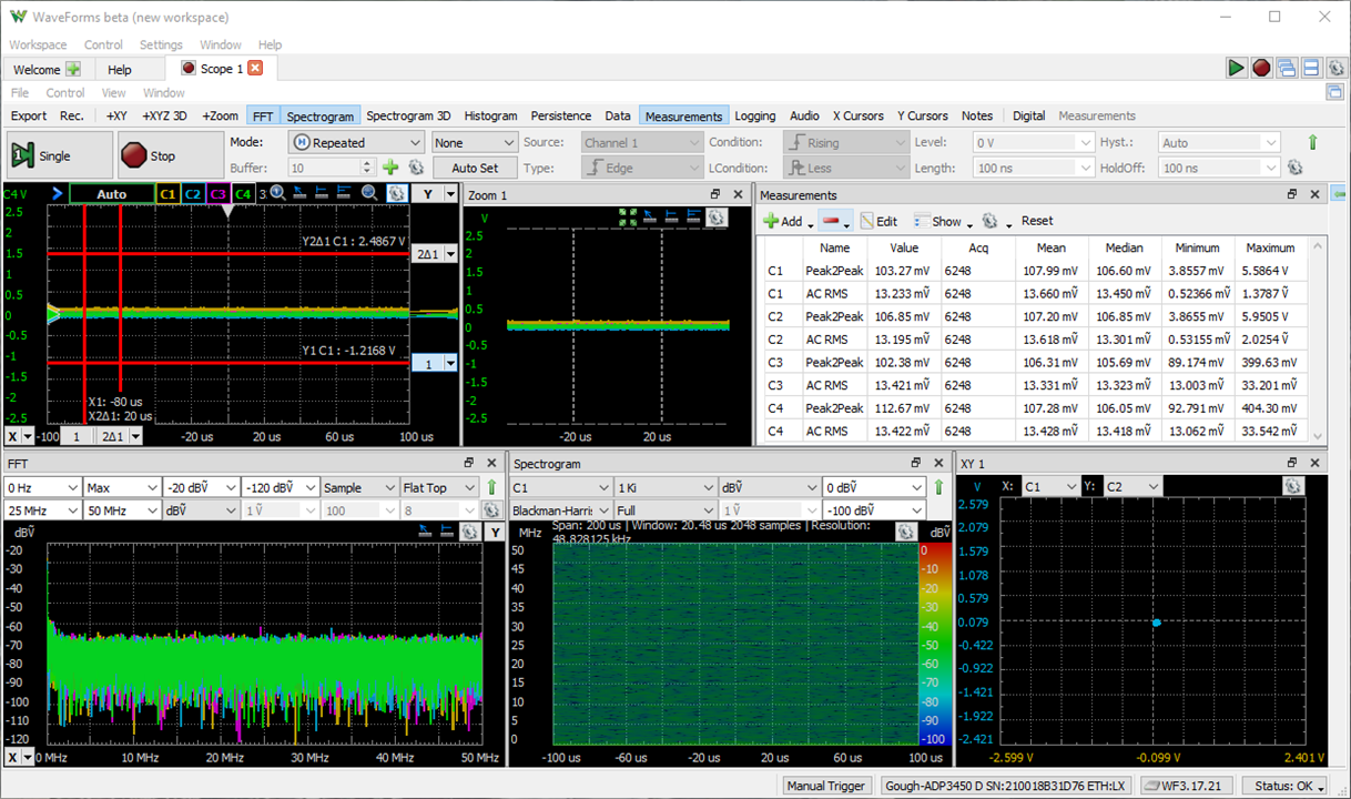

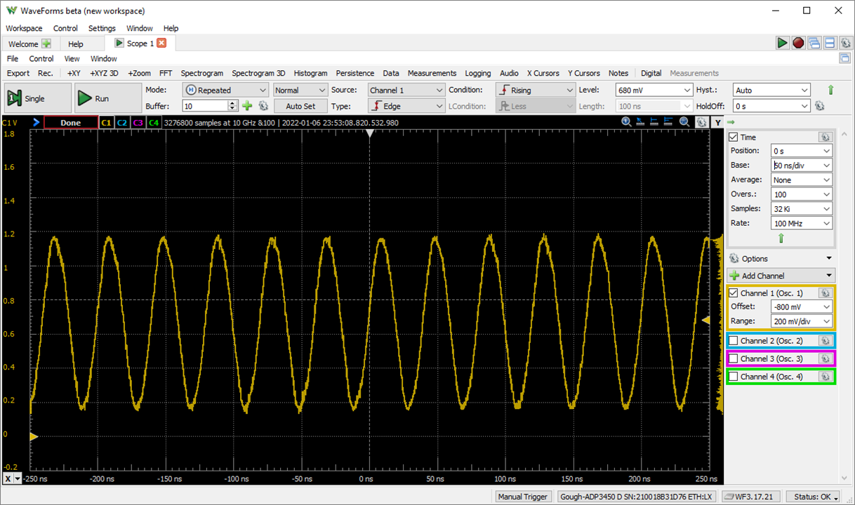

The Scope module provides the most important functionality of the ADP3450, namely the oscilloscope. The tab features a menu bar across the top that allows selecting features, a configuration bar below that and a collapsible channel configuration bar to the right, with channel-specific, time-based and additional options available through the various cog buttons. Additional channels (e.g. math) can also be added. The waveform is plotted in the centre with a histogram to the right side. I have enabled measurements in this case – I am measuring the signal across a 25MHz (nominal) crystal with the ADP3450 running at 100MHz default system clock.
It is clear that the ADP3450’s >55MHz bandwidth rating is perhaps not its biggest Achilles heel, but more rather the 125MSPS maximum sampling rate that defaults to 100MSPS as it is a rounder number as certain time intervals are also derived from the system clock. This results in a “lumpy” resolution of the 25MHz clock, as just four samples are recorded for every oscillation.
For stable, repetitive signals where accurate triggering can be achieved, the oversampling option allows for an increase in effective sample rate but at the cost of significantly increased acquisition time. This technique does not work for non-repetitive signals and will suffer from slight errors in time-offset and trigger-noise resulting in a slightly “fuzzy” look even though the waveform shape is more faithfully reproduced. The above shows the same clock, but oversampled 100 times.
The display is very flexible, allowing for multiple windows to be opened through the buttons along the top toolbar. As a result, it is possible to look at a signal in the time and frequency domains at the same time. Zooming and cursors can be achieved with the small iconised buttons inset into the trace area. Most important measurements can be computed with full statistics, as you would expect. The software also supports plotting XY mode and XYZ mode as well. Unfortunately, as one would expect, performance does suffer when using too many measurements or alternative views.
The oscilloscope offers persistence view as well, but this operates differently to most oscilloscopes, as it does not affect the main view but operates a separate window which does not offer the same in the way of measurement cursors or adjustable persistence decay times which limits its use somewhat.
It is possible to mix digital and analog domains as well, although unlike most oscilloscopes, protocol decoding does not appear to work on analog channels – this means both additional cabling complexity and consumption of both digital and analog channels if you would like to see both domains at the same time by connecting both channels in parallel. On the up-side, both modes offer perfect time-alignment.
Another major limitation of the standard operating modes is the waveform buffer size of 32,768 samples. The ADP3450 appears to operate as a traditional USB DSO where a single waveform buffer of limited size is filled at the digitisation rate and transferred to the computer for display. Only after this is complete, can another capture be taken, resulting in long blind times especially in case of slower computers. In a quick experiment, I measured a blind time of about 15ms between buffer captures on Linux Mode via Ethernet leaves plenty of time for a short glitch to get by. This seems to be the case as the “buffer” number on the screen reflects buffers in the host’s RAM and not memory segmentation on the device itself. Furthermore, because of this limited buffer size, we are limited to observing very short time windows when high sample rates are used, so unless you are “lucky” with the trigger, you might miss the event of interest. This issue is something many big-box oscilloscopes have responded to by having larger and faster memory buffers with better data processing to allow for both long captures and deep-zoom capabilities.
The ADP3450 has a special mode to try and overcome this disadvantage to some extent, known as “Record Mode”. In this mode, the system tries to acquire samples continuously and uses an internal memory buffer to hold the data. The specifications claim up to 128MS recorded from a channel at the full 125MSPS rate only in Standard mode (Up to 1MSPS in Linux Mode), however, I was not able to get this to work stably. Instead, I would receive “samples were lost” at most rates above 12MSPS or the software would hang attempting to do a record mode capture while running in Standard USB or Standard Ethernet modes. This may be because of the size of the data – 128MS of 14-bit samples (padded up to 16-bits each) would be 256MB of data to transfer, at 40MB/s USB2.0 rate would take almost seven seconds. Even though Ethernet is faster, the benchmark only gives the interface about 53MB/s effective reducing the transfer time to about five seconds. This is where the PicoScope’s USB 3.0 interface seems to offer a clear win.
As a result, while the Scope module is very flexible and capable, but it does seem a little cluttered as a result. The hardware limitations of the ADP3450 are apparent with its traditional USB DSO architecture of having a modest sample rate of up to 125MSPS, relatively small sample buffer, use of host history buffers and significant blind time between acquisitions in part due to data transfer bandwidth and processing limitations. While there is a record mode to try and overcome some of these limitations, I was not able to reliably get this to function at high sample rates. As a result, I would not consider this a “professional” oscilloscope, although it is not bad compared with other PC-based entry-level educational or hobby-oriented products.

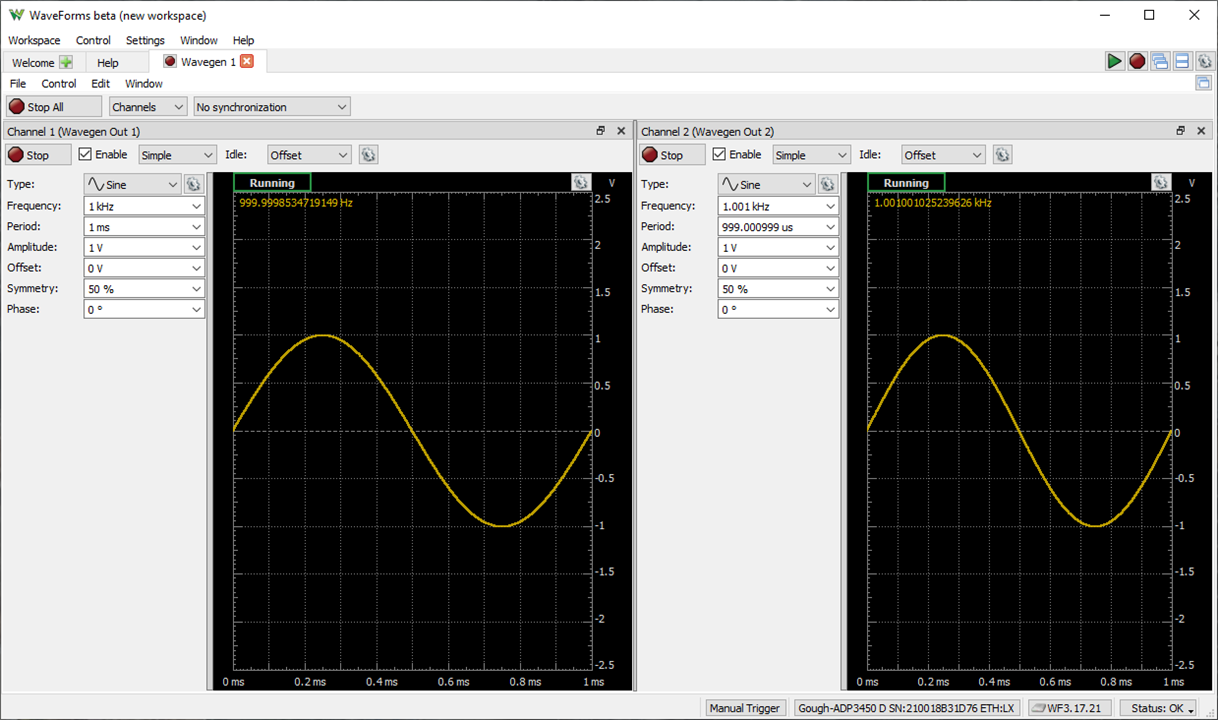

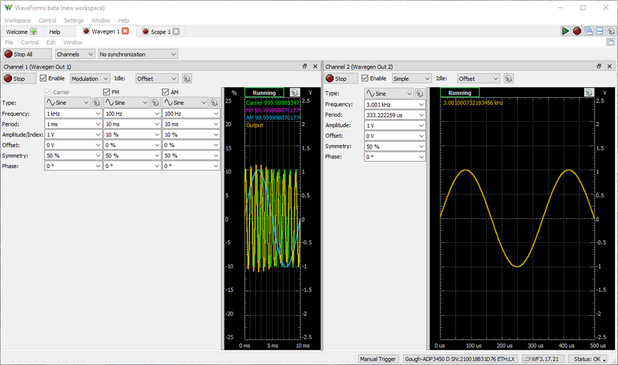

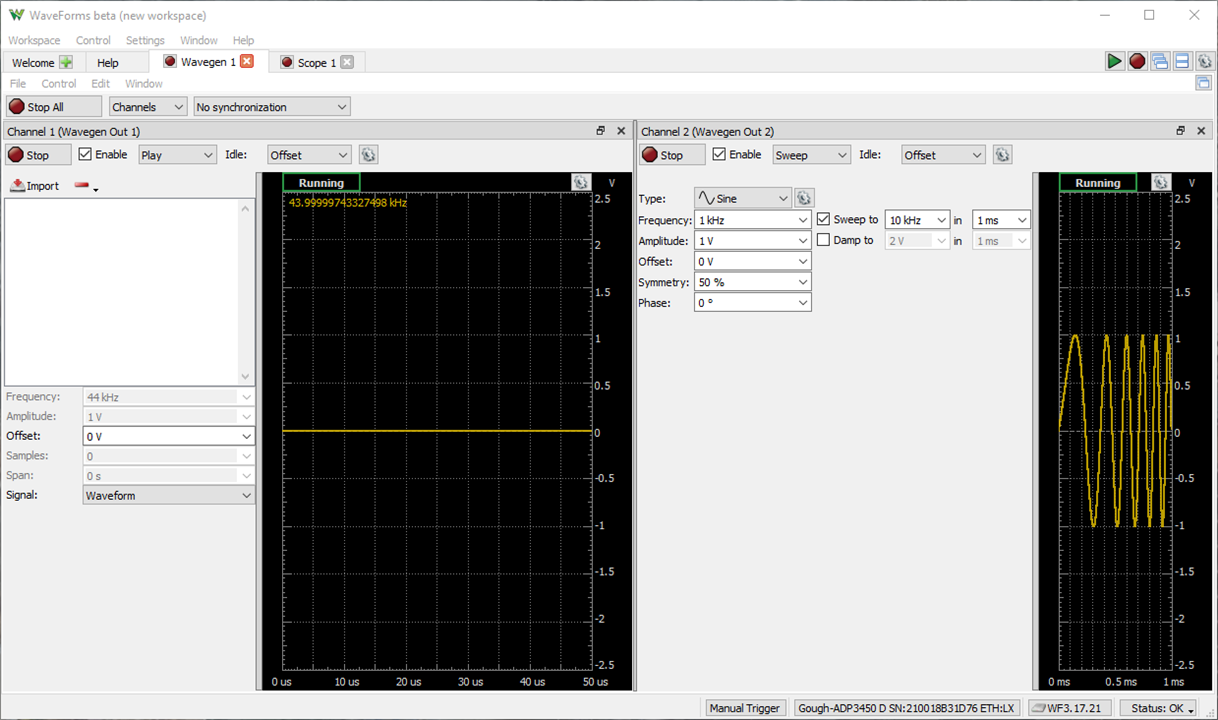

The Wavegen module is home to the two arbitrary waveform generator outputs. This module allows for independent or synchronised use of both channels. By default, the simple mode allows for basic function-generator style controls, while more advanced controls are available in the Basic mode which provides slider-control of values. The custom mode provides the ability to replay custom lists of values.
image image
The Modulation mode allows for AM and FM modulation by a function waveform, the sweep mode allows for the output frequency and amplitude to be swept, while the play mode allows for playing back an audio file from the wavegen outputs.
Compared to most other AWGs I have experienced, this one has a lot of in-built flexibility and functions, diminishing the need to generate your own table of values externally and load it into the instrument. While the 32,768 sample capability of the AWG and the ~15MHz bandwidth does not match-up to standalone instruments, it is still very much more usable than the AWG offered on many USB instruments.

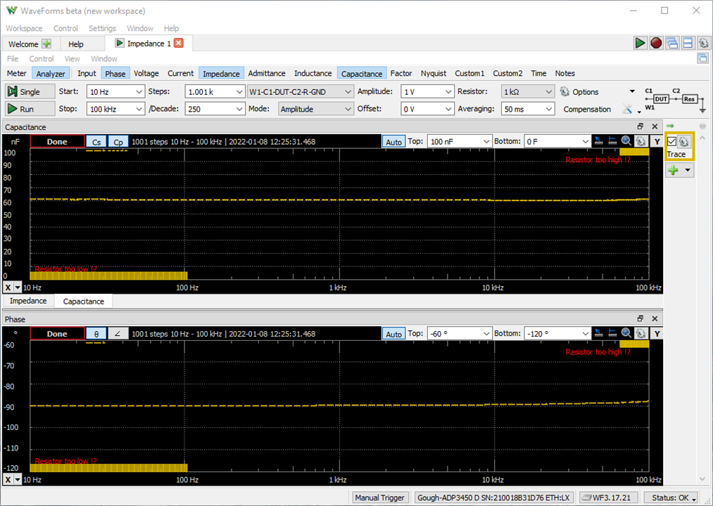

The Impedance module is another useful feature which I haven’t seen elsewhere and is a testament to the useful integration of instruments offered by WaveForms. Considering how few people actually have an LCR meter in their arsenal and even fewer who have a set-up for characterising the behaviour of components across the frequency range, this is perhaps one of the most useful tools. It combines the use of the oscilloscope inputs and wavegen outputs, using an external user-provided sense resistor, to behave as an impedance analyser. It can measure impedance, admittance, inductance and capacitance across the (logarithmic) frequency range to determine its behaviour – quite important for picking the right switching frequency (or matching capacitors/inductors) for a converter or filters.
This particular module has two views – the analyser view which allows you to sweep the full frequency-dependent behaviour of the component, or the meter view which provides a simplified LCR-meter-like view for a single point reading.
While seemingly useful, I did not find the values to be highly accurate as the measurement range can be quite picky with regards to the current sensing resistor. A resistor that is too high or too low can introduce noise into the measurement, while errors in the resistance value will affect the computed result. In spite of the limited absolute accuracy, the frequency-dependent behaviour is perhaps much more valuable and that is displayed well, although the number of points per decade may necessitate multiple scans to narrow in on a cross-over point.

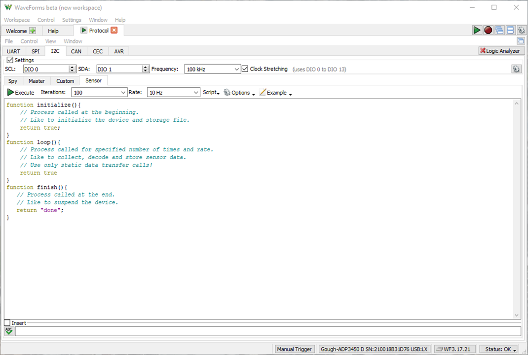

While the Logic module visualises the decoded data on a time basis, there is also the Protocol module which offers the ability to sniff and send/receive data alone without the time visualisation. The data can be presented in various different formats. This module features support for UART, SPI, I2C, CAN, CEC and AVR, however, my experience seems to suggest that at higher rates, there may be issues with data loss and decides can become discontinuous.
image image

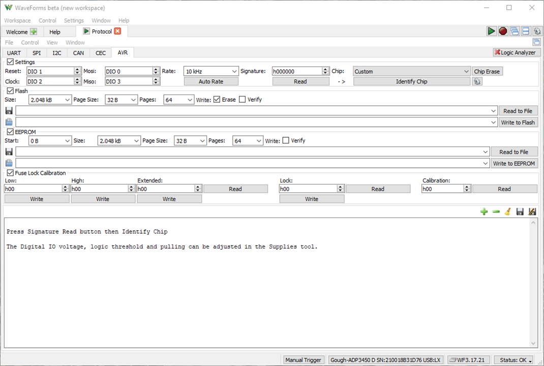

Unlike many other digital-capable tools, the ADP3450 can transmit and act as master because it is an I/O rather than just an input. This is particularly useful especially if testing an I2C peripheral directly, as the scripting feature also allows users to write a Javascript program that can directly read data from connected sensors without the need for an external microcontroller to act as the bus host.
The AVR feature is probably not that often used, but it seems the ADP3450 can function as an AVR programmer which could be useful in case of recovering or reprogramming such a microcontroller. It is a bit of a surprise to see, but seems to build on my impression that WaveForms has been built to do useful things with the hardware where possible.
