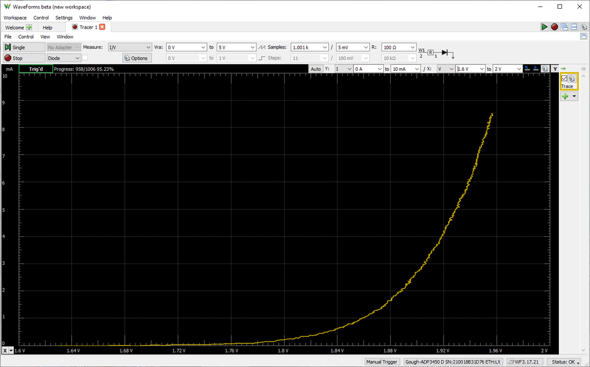

I-V Curve Tracing
Want to do some curve tracing? The Tracer module is for just that. I decided to put it to use by first tracing out an ordinary power diode. The user needs to supply a sense resistor that is used to measure the current flowing through the circuit as a voltage – for tracing other semiconductors, you may need two such resistors. The values should be in decade steps – 1, 10, 100, 1k, 10k, 100k or 1MΩ.
For now, I’ve just hooked up probes in X1 mode and set the unit to trace. It’s fairly quick at tracing but the trace is noisy and can be lumpy especially if a non-ideal resistance is used. The trace current available is limited by the wavegen outputs but also by the achievable voltage of the wavegen which is dropped across the semiconductor and sense resistor. In this sense, it’s not as ideal as using an SMU, but it is faster, more like an analog curve-tracer but without the control knobs.
image image
A diode is easy, so how does it go with a higher-voltage device like an LED? Turns out, it does rather well. I think this makes it quite useful as an educational tool.

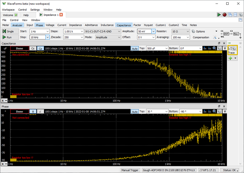

Impedance Measurement
I’ve not had an impedance analyser myself, but the thought of having one is quite interesting to me as I know real-life capacitors and inductors behave differently depending on frequency and this can be a problem depending on your application. It’s part of the reason why LCR meters have selectable test frequencies. Having the Impedance module allows for the characterisation of components as a function of frequency.
image image
Starting off gently, I test a through-hole resistor which should be flat. For the most part, it is, but it seems to increase slightly above 1MHz in part because of stray capacitance it seems. At least it proves the system to be working, even though in this case, I probably didn’t pick the ideal value of current sensing resistor. Of course, not all resistors are purely resistive – a wire-wound has inductive properties at higher frequencies, in the case of this 6-ohm 25W unit, above 50kHz it starts to show some inductive properties.
image image
Both of the curves above come from a 100nF capacitor, with the left one being ceramic and the right being polyester. It is hard to find a sense resistor that covers a full range without triggering the “resistor too low/high” warnings, but as long as the curves are not too noisy, it will do. It seems that the polyester capacitor is more stable at frequencies up to about 200kHz while the ceramic seems to be declining in capacitance steadily, but only starting to make a major turn by 300kHz.
Looking at the impedance graph for the polyester capacitor, it’s clear that the impedance follows a straight line but at 1MHz, an inflection point is reached. This is the capacitor’s self-resonance, a point where the capacitor stops being a capacitor essentially.
Electrolytic capacitors don't handle higher frequencies that well, as can be seen in this trace of a 470uF electrolytic.
image image
Inductors, too, have a self-resonance frequency. The above is a 1.2mH power inductor and it is pretty much done by 850kHz with the curve seeming to indicate it is best used below about 500kHz with its value deviating somewhat by 200kHz. The frequency in part is determined by geometry and core material of the inductor.
A smaller 68uH power inductor has a higher self-resonant frequency about 5MHz.
