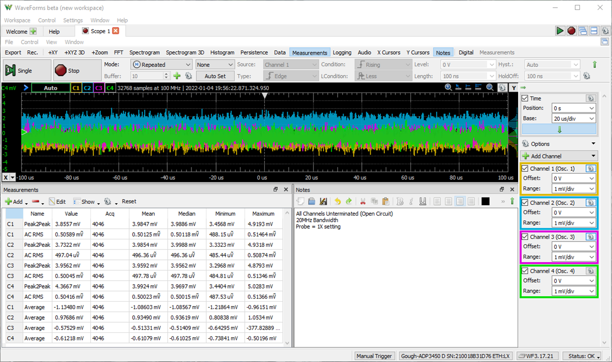

The most traditional method of quantifying an oscilloscope’s noise floor is to do an all-channels-open or all-channels-terminated test. I decided to do this with all terminals open as this was the easiest to achieve.
With the setting at 1mV/div which presumably has the front end in the 1V range, the channels showed a mean peak-to-peak noise around 4.25mV and an RMS noise of about 0.53mV. The theoretical quantisation noise for an ADC of 14-bits (16,384 levels) at the 1V range (-1V to 1V = 2V span in the ideal case) equates to 0.122mV. This implies that the inputs have about 9-bits of clean resolution in this range.
Engaging the 20MHz bandwidth limiter reduces the mean peak-to-peak noise to 3.99mV and the RMS noise to 0.50mV which is only a slight improvement.
Terminating the first channel into a 50-ohm BNC terminator did not result in any appreciable change to the noise readings, although I found shorting the inputs on the probe itself did result in increased noise levels due to pick-up in the probe and shorting loop.

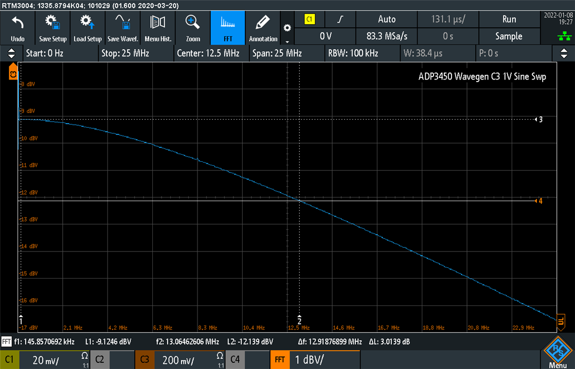

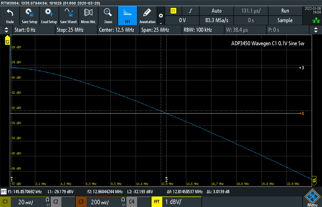

However, using the instrument to judge itself may not be a fair test, so I also repeated the test with the output set to 1V amplitude hooked into my Rohde & Schwarz RTM3004 Oscilloscope with the termination set to 50-ohms to more fairly replicate the conditions expected when actually driving a matched load.
image image
The results suggest that the 3dB bandwidth measured around 12.7MHz which is less than the claimed 15MHz on the datasheet. It also has a different shape to that of the above test – perhaps it cannot achieve the result when driving a 50-ohm load. The result is virtually identical for the second Wavegen channel with a bandwidth of 12.9MHz.
Just to be sure, I tried again, but with 100mV amplitude in case it is slew-rate limited, but the results were virtually identical.
I also decided to try again but with a 5V amplitude as there are separate ranges involved, in case the high-range has a better frequency response into 50-ohms.
Unfortunately, and as expected, the bandwidth was actually lower at a 5V set amplitude, reaching 10.4MHz. Just to be sure of the results, I re-tested using high-impedance mode.
The 3dB bandwidth has increased to 16.4MHz which is very similar to the original measurement. As a result, it seems that the full bandwidth is not available when the output is loaded.
