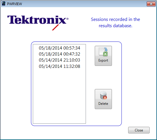

Firmware and Software Update
In my case, the instrument was shipped with initial release firmware, version 1.000.000. The probability is high that new software and firmware are available, so it pays to check on Tektronix's website for them and update them accordingly. Updates normally bring improvements in stability, bug fixes and feature additions. I would recommend new users to perform these updates immediately, and periodically where new software is released.
The latest version of PWRVIEW (which is v1.1.4.110 at time of initial writing but since superseded), available free from Tektronix's webpage, installed just fine on my Windows 7 32-bit computer. It co-existed with my Keithley Model 2110's NI-VISA installation, as it seems the PA1000 also uses the NI-VISA runtime. The installation package is also available for 64-bit machines and is qualified for use with Windows 7 and 8.1 at this time. It's important to note that the software will also download and install NI-VISA runtime if not already installed, which is not packaged in with the installer, so the computer you are installing PWRVIEW on will require an internet connection. Furthermore, if NI-VISA is not already installed, the system must be restarted to complete the installation.
It is recommended to install PWRVIEW first before installing the Power Analyzer Firmware Update Utility to ensure the VISA communications layer is correctly installed. Please download the utility and the appropriate bin file which contains the firmware image for your power analyzer.
Once the utility is installed, it can be started up and the communications layer tested. The PA1000 must be connected by USB for the firmware update process. Once the communications has been verified to be functional, the tool can be pointed to the appropriate .bin file (at the time of writing, the latest version is PA1000Firmware_1_001_006.bin) and the flash process begun.
Be patient while the firmware update is in progress. During the process, there will be several stages where the process appears to stall, but it is progressing. Any interruption will ruin your instrument and possibly require return to the manufacturer to restore to functional order. The whole process takes about 3-4 minutes.
The Release Notes attached to the firmware indicates the addition of a command :SYST:ONTIME? to obtain the time in seconds since the instrument was booted, a change to the FRF query to return the number of parameters and results to be returned with the original FRF command changed to FRF_LEGACY, and a fix to Ethernet IP addresses not being retained through power cycles.
Further details on the operation of the PWRVIEW software will be detailed in a later part. The update has also updated the help which now reflects the correct URL for Tektronix.
This review was conducted using a mix of Firmware version 1.000.000 and 1.001.006 and with PWRVIEW v1.1.4.110. Users should note that a new version of PWRVIEW has been released just before the publication of this review, and another firmware and software release is slated for mid-August with more releases promised before the end of the year. As a result, many of the issues identified may have been fixed by the time you come to use it.

The Measurements tab is the main tab for use with most modes. The measurement tab allows for you to configure the acquisition parameters - number of significant figures (generally, with Averaging at 1, the data returned contains 5 significant figures), the amount of averaging (Auto, recommended, applies an averaging value of 8, but configurable from 1-64) and whether Zero Blanking is enabled (which clips very small values to zero).
It also allows you to save settings, start and stop an acquisition run, take a snapshot of the data, continuously record data into the database, export recorded data, and view waveforms and harmonic bar charts.
This tab has a body which resembles a spreadsheet in more ways than one - while data appears in columns from each instrument, free cells can have formulae entered to perform real-time calculations on collected data to compute parameters not directly measured.
To begin seeing live values from the instrument, after having first configured the power analyzer to your liking, you simply need to click the Start button. Values will begin populating the columns at a rate of about two values per second which is not adjustable. I still find it a little strange, given the waveform and continuous sampling abilities of the PA1000, that it returns values only once every two seconds - in some sense, more like a multimeter than an oscilloscope. For those looking to capture very transient events, such as switching glitches, or flicker in mains waveforms, I don't think this meter is capable of it, although the hardware is possibly capable of doing so. It is noted that the PM1000+ on which this is based had some ability to measure flicker, however, no mention of this is made by Tektronix.
To record a single reading, you merely have to click the Snapshot button. To perform continuous logging, you can click on the Record button. Clicking on it again stops the recording. A list of prior recordings is available under the Data button.
Selecting any one of the recorded data sets (displayed by date-time) allows the data to be exported in a Microsoft Excel .xslx file with two sheets.
The first sheet contains the metadata, with the second sheet containing the values including absolute timestamps. Hurray!

But, unfortunately, with every hurrah comes a bit of a disappointment in the performance of the database. On a modest AMD APU based system, exporting a spreadsheet can sometimes take several minutes to complete as it combs through the database.
When the database starts getting a little big, it gets frustratingly slow to work with - even if that is to delete and clear the database. There's no bulk-delete or bulk-export features yet, meaning that you must independently deal with each data-set. In fact, if you log for an extended period of time (about 30 hours was enough for me, resulting in a database file greater than 100Mb), you can find the database data will not be able to be exported, and instead displays an error.
The database is actually in SQLite format, stored in %appdata%\Tektronix\ which, given an appropriate viewing application, you may be able to generate the requisite query to export the desired data. I haven't had the time to analyze how the tables are related, but it does open up in SQL Lite Viewer, although performance is still an issue. You can delete the database file with no ill effect, except for clearing all the recorded data.
Tektronix has been informed about the performance issues with the database, and have informed me that some improvements will be made for the next release due mid-August, with further improvements to be made over the next few releases.

I think it's pretty clear that the PWRVIEW software makes standby energy compliance testing very simple. It implements the Sampling Method in an almost completely automated way, making it very simple to check for standby energy compliance. The main problem was with my mains and difficult appliances!
