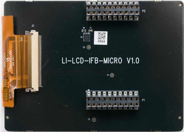

Having run the provided demonstrations, I decided to embark on separating the stack to get a view of the insides. This took some careful prying to avoid snapping or bending any connectors. It took a bit more force than I would have liked, but I managed in the end - those Samtec connectors grip really well!
The back-side of the LCD and camera boards don't have much to show ... but the main board is perhaps the more interesting one with regards to potential reuse.
This board also explains why the kit is a bit on the pricey end. While it has the promised Microchip (Microsemi) SmartFusion 2 M2S010 VFG256 FPGA (Made in Korea), it also has a Microchip PIC32 PIC32MX795F512L-80I/PF microcontroller which I did not expect, but perhaps its main function is just to act as a programmer and interface to the FPGA. It features a Microchip MCP2221A USB to Serial adapter which is how it talks to the computer, Micron Technology MT41K1G8RKB-107 8Gbit DDR3 SDRAM and a Microchip 26F064B 64Mbit SPI Flash. Perhaps one downside is the use of a rather antiquated mini-B connector - a USB-C connector (or micro-B) would be more contemporary.
