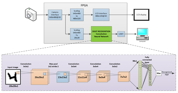

The third demonstration was the one I really wanted to try. This one uses a convolutional neural network trained on the MNIST database to perform handwritten digit recognition in real-time from the camera. This implementation has ten classifiers, always outputting a digit of highest probability. The use of FPGAs to accelerate AI tasks is a growing area of interest and the power usage indicated (0.2W) is quite efficient at first glance. I tried it with the on-screen digits, manually focusing the camera to try and get the sharpest image but also trying to avoid moire. The results were mixed.
So I decided to challenge it, by drawing digits on paper by hand with a gel pen (missing out zero). The results were not that encouraging ... perhaps the model was too simple to reduce resource and power utilisation at a cost to accuracy.
It seems there's a bit of a preference for 2 and 3 ... only 2, 3, 8 were correctly identified from my sequence of 1-9.

    Thanks for the comment wolfgangfriedrich! Indeed, when I meant "quick", that just means it's something I have done over a day or two of spare time. A way of setting expectations, I suppose. That is in contrast with a RoadTest which usually takes up closer to two-months of spare time. It's mainly just to say that perhaps there might be more to come and not to expect me to delve into the depths of Libero and their IP blocks.
    Indeed, the way I write is very much my own "style" in a way ... doctor's handwriting? But I did also think that perhaps a thicker pen may help the algorithm as it may provide higher contrast. The bars may have definitely skewed the result given MNIST on which it is trained is probably US-originated.
    The model is given as detecting a 28x28 pixel bitmap of black and white only (one-bit), so that is definitely a simplification that helps reduce the amount of work the FPGA has to do. It's not necessarily all that deep of a network with four layers, but there isn't any information about how accurate this model was trained to be in the first place. I wouldn't be using it to scan cheques ... put it that way! Love the story regarding prices image should have asked for a discount!
