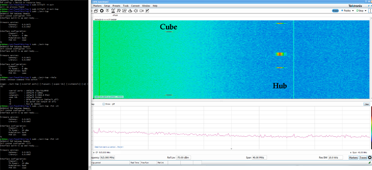

Wanting to understand the sort of signal that was being emitted from the ZWIR4512, I set the spectrum analyser to view the relatively-quiet 915Mhz band.

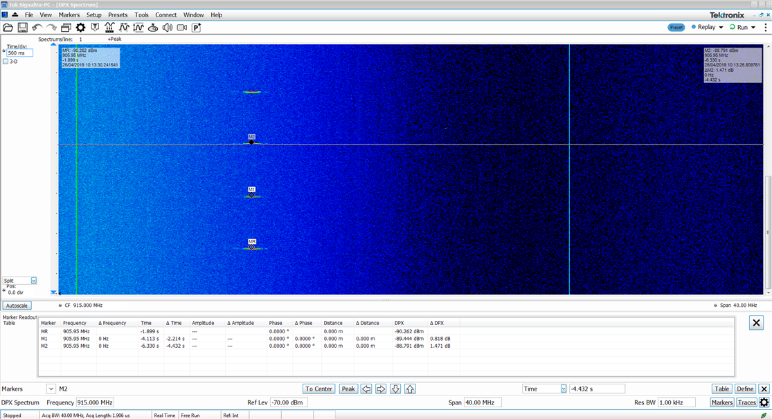

It was determined that the cube and hub were operating on 906MHz. With the report rate set to 2000ms intervals, the recorded transmission burst interval times were slightly longer, at 2216ms on average.
It appears that each report consisted of two radio bursts was about 15-18ms in length, spaced apart by around 24ms.

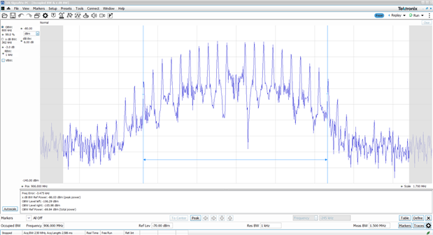

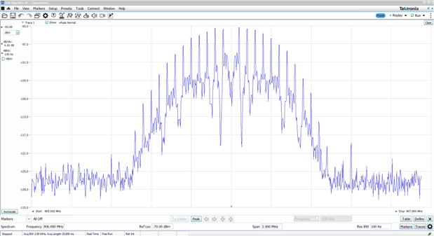

When viewed on a 2MHz span, it seems that the signal occupies roughly half, or about 1MHz of bandwidth judging by eye. The Occupied Bandwidth module suggests the 99% power is contained within 800kHz, and 3dB bandwidth is 362kHz, but this may not be too accurate due to the spiky nature of the signal.
Channel Support

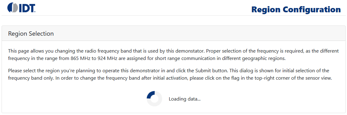

Unfortunately, even after several reboots of the cube and hub, the system was not persuaded to change channels. The unit remained on 906MHz which is a problem as operation on this frequency is illegal in Australia as it is part of the commercial mobile telephone service (CMTS) band. Looking at the spectrum analyser, the band is rather quiet and seemingly not used, but it may be an uplink channel thus quietness is to be expected and continued operation of the ZWIR4512 module in this configuration may degrade the communications quality for mobile phone users. This is unlikely due to low transmission power, but to avoid inconveniencing others and potential litigation, it’s important to use only frequencies you are licensed to use and adhere to the license conditions.

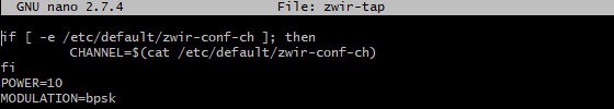

It was determined that through /etc/default/zwir-conf-ch that the operating channel could be set for the zwir-tap service. The modulation and power could be set in zwir-tap but I'm not certain they are adhered to.
Changing this value did appear to do something – namely it seemed to break the IDT HTML interface as now it became confused about the region.
Instead, I found it easier just to stop all the zwir-tap services, and invoke the zwir-tap program manually, requesting a channel number on the command line. Here, it is visible that the channel has been changed and the hub is now on a legal frequency. Unfortunately, the hub did not follow which is contrary to what the manual had stated.

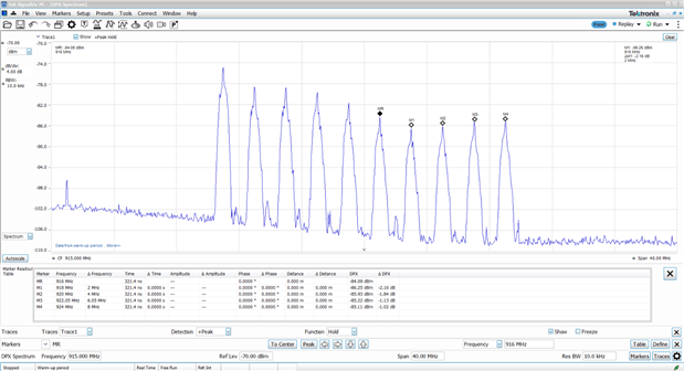

Using the peak-hold feature of the spectrum analyser and stepping through the supported channels, it can be seen that the channels start at 906MHz and are spaced by 2MHz with a total of 10 channels.
Through enquiry with the manufacturer, it appears that the cube firmware is configured to scan just two channels, one in each region, to save battery life in case of loss of contact with a hub. Unfortunately, their choice of channel makes it illegal to operate the SDAWIR03 kit in many countries including Australia despite the ZWIR4512 module being capable of operating at the correct frequencies and power levels. This is very unfortunate and limits the appeal of the SDAWIR03 kit to those in the EU and US (North America, Mexico, Brazil) regions only.
I have suggested that they choose another channel, perhaps 916, 918 or 922MHz which are channels which are common to nearly all the 915/920MHz band countries in the IEEE 802.15.4 standard.
