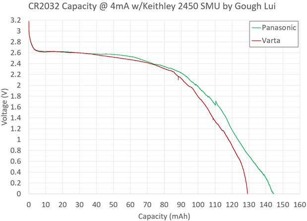

I wanted to understand how much of an effect this might have on the usable capacity of a cell, thus I wanted an experiment that would discharge a cell at 4mA (a rough average of modern heavy-load applications) and at 0.5mA (which is the approximate maximum continuous load specified by some CR2032 cells). I thought of conducting this experiment a while back, but I did not because the B&K Model 8600 DC Electronic Load and the Rohde & Schwarz NGM202 have current setting accuracies with uncertainties of 0.05% + 1.5mA and 0.02% + 2mA respectively. This would mean that we have very little control and certainty over the current! Thankfully, source-measure units are much higher precision instruments and in that range of current values, the expected error was 0.02% + 1.5µA at worst (10mA range), making it worthwhile to conduct the test.
My first test was to discharge at 4mA. Two reputable CR2032 cells were chosen, a Panasonic and a Varta. Each test run was performed using a four-wire jig which I made from an old PCB holder and some gold-fingered battery spring contacts. Slight jumps in voltage may be due to vibration affecting the contact stability. Each run took approximately 34 hours.
Compared to the commonly quoted datasheet values for CR2032 cells which are around 225-230mAh, the cells delivered much less at the 4mA current. For a 2.0V cut-off, the Panasonic lasted slightly longer than the Varta, but the delivered capacities were in the range of 94-100mAh. Slower bumps and variations were due to room temperature changes which were uncontrolled predominantly affecting the battery, but remained within accuracy limits for the instrument.

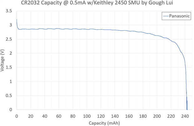

To run the same test for a current of 0.5mA would take much longer, around 19 days. As a result, just for verification purposes, I performed the test with the Panasonic cell only.
The cell is specified for a capacity of 225mA, with the test showing it delivered about 236mAh which is slightly above the claimed capacity. This clearly illustrates that the cell definitely can deliver the specified charge, but only at lower rates.

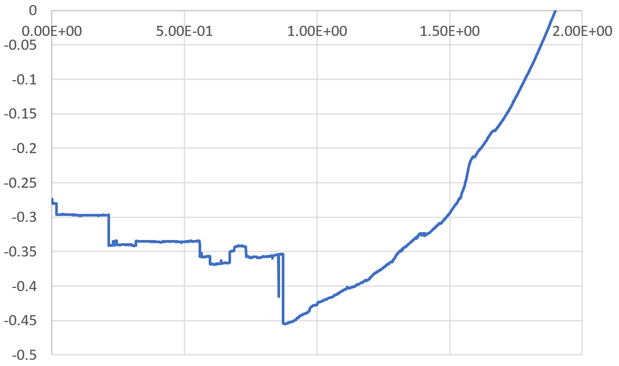

Unfortunately, while things appear all nice and smooth, my experience with my particular 2450 was a bit perplexing. With the PV panel exposed to a fixed source of artificial light, running an I-V curve using my own SCPI code (as my KickStart 2 trial has expired) for the first time resulted in strange “bumpy” curves with values that were initially below the expected value, suggesting that on certain ranges, the unit really wasn’t measuring what I was expecting. Was this a quirk with the auto-zeroing on the unit, an intermittent contact or something else entirely?
I couldn’t get a firm answer on this, but to say that if I re-ran the test three times, usually the last result actually looked right. Perhaps it was a contact issue somewhere that settled on its own or by vibration or slight movements. If I didn’t want to just keep trying until it seemed okay, rebooting the unit restored the right output first-time. I really don’t know whether this was because of the unit or some external influence, but it really did bug me that I couldn’t understand why it was happening. The panel was connected with the supplied test-leads which had a very “springy” retracting hook setup which I would have expected to be sufficient for the currents involved.

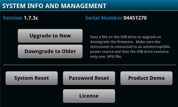

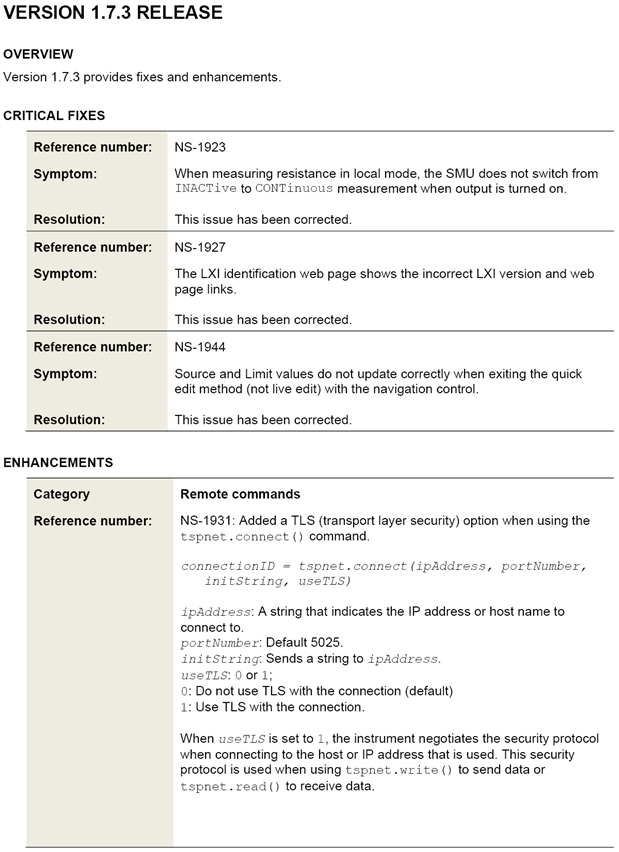

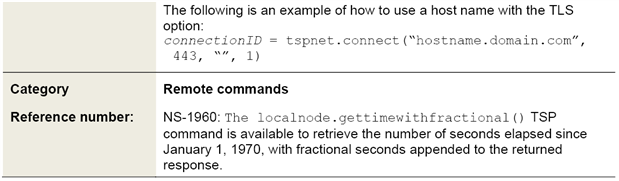

Since the review, a new firmware version 1.7.3 has been released which fixes a number of issues and adds some improvements. The changelogs from the release notes are as follows:
I was keen to apply this update to see if it would make any changes to the issues I had experienced with the SMU. The process of updating was straightforward and identical to the last, taking several minutes and was ultimately successful.
Unfortunately, the overheating problem persisted (which is no surprise) but also I experienced a one-off glitch where the unit booted up thinking it was under remote GPIB control (with nothing attached) and the output became uncontrolled. Attempting to take local control caused the unit to lock-up. Fortunately, this issue did not persist after a reboot.
But perhaps the biggest good news to come out of this firmware update was an acknowledgement of an issue with using high-impedance mode and/or four-wire sensing mode where readings would stop when the output was turned off but not restart when the output was turned on. I received confirmation that this is not the intended behaviour and instead this firmware fixes it for resistance mode but I had picked up on the other two cases that were not patched. The bug was apparently introduced in version 1.7.0 – with such a complex instrument, the software is quite hard to audit!
As a result, we expect a fix for this issue in an upcoming version 1.7.4 firmware release, which is good news!

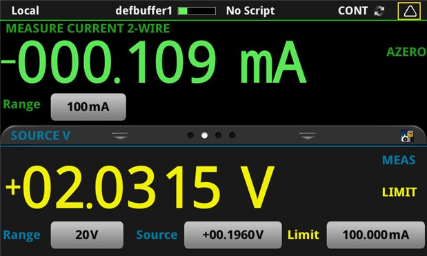

Unfortunately, perhaps due to the sheer number of queries and their limited resources, I have not had any clear explanation for “Overflow V” being recorded on auto-ranging or I-V Characterizer runs, nor for parameter error messages in I-V Tracer, the trial-date message for I-V Tracer or the voltage regulation tightness on a load-ramp test which seemed a little wide. My personal suspicion may be that these issues could be particular to my unit or test setup as I observed this perplexing result as well in a range that usually works just fine –
A limit of 100mA is selected and sourcing 0.196V is requested, but the unit hits a limit sinking 0.109mA (which implies it’s actually in 0.1mA range rather than the requested 100mA range) thus the voltage sits above the requested voltage.
I’ve also encountered strange incidences where toggling the range back and forth while re-setting the same current limit each time results in significantly different readings – it may limit when changing one way, but repeating the change provides the right result without a limit annunciation. I suspect there may be a bug or issue with my unit here and have forwarded a video along with .tsp setup file by e-mail, but it has not been examined as of yet. Other times, strange readings occur but after rebooting, it works just fine (e.g. in the I-V curve testing of the OPV cell above).

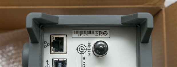

My 2450 Prepares to Depart for Surgery

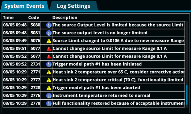

As the observed overheating messages while using the 200V range were rather permanent and concluded to be hardware related, the unit would have to be returned to a service centre for repair.
We were fortunate to receive an explanation from the representative as to the cause, which I have paraphrased. The cause of the fault was due to a change in the parts of the ranging circuitry aimed to improve instrument response. It caused unintended oscillation when operating on the 200V range at particular voltage and current levels which caused the instrument to falsely believe it was overheating. This was not detected as the routine auditing used fixed combinations of voltage and current that did not coincide with the issue. A fix has been developed and validated which uses passive components to correct this without affecting the specifications of the instrument and improved auditing procedures which cover all ranges and quadrants have been instituted to ensure such issues would be caught in the future.
Unfortunately, as I did not purchase the unit, the process was rather complicated and involved a number of staff at Tektronix performing internal processes to clear a path for the unit’s return and repair which took a few weeks. Furthermore, I would have to ship the unit to Singapore (presumably at my cost), whilst locally sold units may have the support and backing of our local distributor and avoid such hassle.

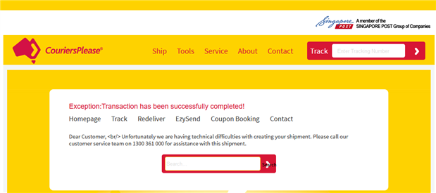

The process was not as smooth as expected, for a number of reasons related to the Australian Government regulations, our postal services and the information provided. My first hurdle was simply the declared value of the parcel which exceeded our postal service’s thresholds and required me to apply for an account with our border force to obtain permission for export, with everything geared towards commercial entities and requiring a lot of work. The easier route appeared to be eschewing the postal system entirely and sending the unit via a courier service. This is when I discovered the postal code provided was incorrect, which took a day to clarify. Even then, certain bits of information such as the HS Tariff Code were not provided and I had to obtain it from the original shipping documents. The RMA was missing an RMA number, which I had to request from them, adding another day to the process. Granted this is an exceptional circumstance, but I expected things to be a bit easier … I guess it’s common to underestimate the challenge!
Just when I thought I had found a service that would economically bring my parcel to Singapore, it turned out that after I keyed in my card details, it would fail at the last step because the package was overvalued, but the limit was not documented anywhere. I tried again with a lower value, and it “failed” while claiming to have succeeded. My card was not charged and no confirmations were sent – but Couriers Please was a division of Singapore Post, so I expected things to just work.
I had to contract a different courier (DHL) to carry my parcel – at least they accepted my order and generated a waybill, but ultimately I did not opt to insure the parcel because the cost with insurance was about AU$550 (~US$400), but the cost without was about AU$330. That’s definitely more than I’ve ever spent on a RoadTest on out-of-pocket expenses – in fact, prior to the pandemic, I could literally hop on a plane and fly to Singapore and back for a lower price on a sale fare!

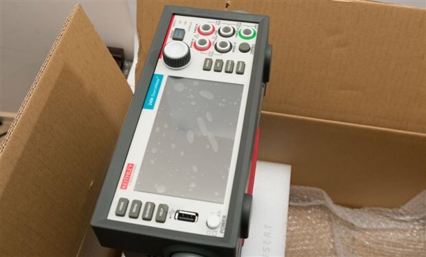

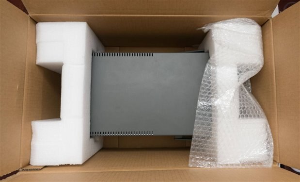

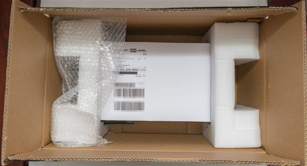

The unit was safely packed, taped up and weighed. It was then unsealed, as DHL requires the unit to be open for inspection and they will seal the consignment. Bubble wrap was added to ensure extra protection for the screen, while padding a little slack space because of the box expanding slightly due to prior shipping.
As of now, the unit still resides at my premises, awaiting pick-up on Monday to begin its long journey. Assuming all goes well and there are no issues with paperwork or customs, the unit should arrive in Singapore where Tektronix will forward the unit through to a service centre in the USA for it to be repaired, recalibrated, tested and returned to me. Hopefully this will permanently resolve the observed quirks and issues experienced during the RoadTest.
