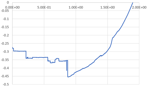

Recently, I did a review of the Epishine organic-PV light energy harvesting evaluation kit through direct contact from element14. The Keithley 2450 SMU was definitely a key player in running the I-V tests in the second review posting, being able to measure microamps with clean, smooth precision despite the sub-optimal set-up.
Unfortunately, while things appear all nice and smooth, my experience with my particular 2450 was a bit perplexing. With the PV panel exposed to a fixed source of artificial light, running an I-V curve using my own SCPI code (as my KickStart 2 trial has expired) for the first time resulted in strange “bumpy” curves with values that were initially below the expected value, suggesting that on certain ranges, the unit really wasn’t measuring what I was expecting. Was this a quirk with the auto-zeroing on the unit, an intermittent contact or something else entirely?
I couldn’t get a firm answer on this, but to say that if I re-ran the test three times, usually the last result actually looked right. Perhaps it was a contact issue somewhere that settled on its own or by vibration or slight movements. If I didn’t want to just keep trying until it seemed okay, rebooting the unit restored the right output first-time. I really don’t know whether this was because of the unit or some external influence, but it really did bug me that I couldn’t understand why it was happening. The panel was connected with the supplied test-leads which had a very “springy” retracting hook setup which I would have expected to be sufficient for the currents involved.

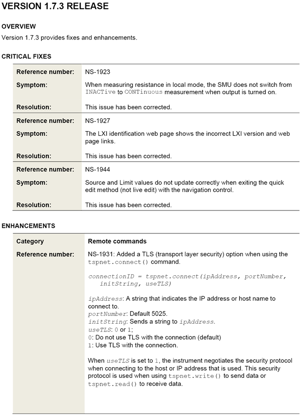

Since the review, a new firmware version 1.7.3 has been released which fixes a number of issues and adds some improvements. The changelogs from the release notes are as follows:
I was keen to apply this update to see if it would make any changes to the issues I had experienced with the SMU. The process of updating was straightforward and identical to the last, taking several minutes and was ultimately successful.
Unfortunately, the overheating problem persisted (which is no surprise) but also I experienced a one-off glitch where the unit booted up thinking it was under remote GPIB control (with nothing attached) and the output became uncontrolled. Attempting to take local control caused the unit to lock-up. Fortunately, this issue did not persist after a reboot.
But perhaps the biggest good news to come out of this firmware update was an acknowledgement of an issue with using high-impedance mode and/or four-wire sensing mode where readings would stop when the output was turned off but not restart when the output was turned on. I received confirmation that this is not the intended behaviour and instead this firmware fixes it for resistance mode but I had picked up on the other two cases that were not patched. The bug was apparently introduced in version 1.7.0 – with such a complex instrument, the software is quite hard to audit!
As a result, we expect a fix for this issue in an upcoming version 1.7.4 firmware release, which is good news!
