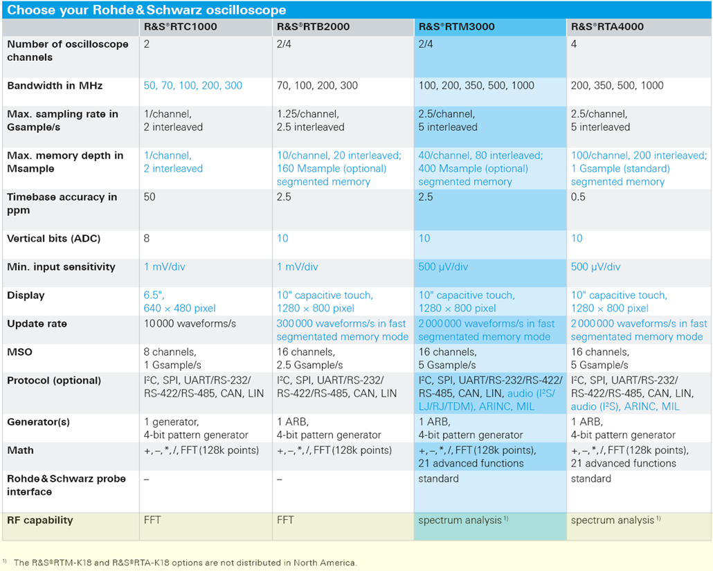

Unfortunately, it seems that access to the K18 Spectrum Analysis feature is still restricted in North American markets according to the current brochure.

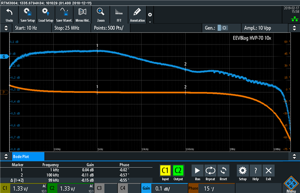

Experiment: EEVBlog HVP-70 vs Micsig DP10013 High-Voltage Differential Probes
Knowing that the K36 option actually works quite a bit better than expected was a good result. But then I thought, how would I apply this to test something realistic?
I recently acquired two high-voltage differential probes and did some basic testing for a review. One thing I did not test was the frequency response. While the HVP-70 claims 70Mhz and the Micsig DP10013 claims 100Mhz which are both far in excess of the 25Mhz capability of the K36 option, I still thought it would be good to test their frequency response characteristics anyway.
With the EEVBlog HVP-70 in the 10x position, the frequency response is generally quite good, measuring within around 0.1dB up to 100kHz, deviating by <1dB up to 25MHz. The phase is mostly around 0, deviating above 1Mhz. This might not be too surprising as the HVP-70 was similar in design to a 25Mhz unit from Sapphire.
At 100x, the performance was a little less consistent, deviating by a maximum around 1.2dB, but this is still well within expectations and still mostly smaller than the claimed margins of gain error.
The Micsig was much more interesting, while attempting to be flat, there is actually quite a bit of deviation upwards at higher frequencies as if it’s an attempt to boost the upper frequencies.
At 500x, the bump is less pronounced, although the response deviation seems a little greater. I’m not sure why but the horizontal grid-lines disappeared from this screenshot.
The thing I love most is that the K36 makes this type of testing as simple as connecting the probes to the right places and pushing a button. Nothing difficult, nothing complicated and potentially highly suitable for teaching analog electronics where testing passive/op-amp based filters would be a common laboratory experiment.
