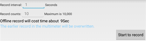

The unit is able to collect up to 10,000 readings "offline". I tested this overnight and it worked as expected, but the downloaded data number is represented strangely - doubled as it contains time and value pairs, but also it seemed to read more than the number of values available.
The other screen of concern is the graphing screen which shows a table of data values and a plot. This table of values is actually being recorded from the DMM and can be saved to file. Existing file records can be loaded for plotting.
From this screen, it is possible to change the logging interval, limit the recording period and change certain settings. The data export is CSV formatted, but the files are somewhat strange -
