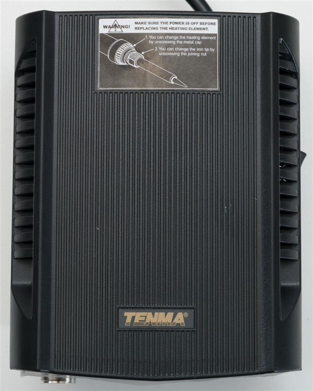

The unit came inside a medium sized rectangular cardboard box with the Tenma logo printed in black in the top left corner. Along the other sides of the box, a model number was listed.
The box had come apart during shipment, thus I tried to repack the items as they may have been originally packed. This includes an instruction leaflet on top. The unit is protected by plastic bags and foam pieces. The base unit on the left has a bit of weight to it, indicating it is a conventional transformer-based design. The stand is on the right, and the unit is equipped with a UK power plug.
Underneath the plastic wrap, the display is protected by a piece of cling film, the soldering iron tip by a piece of hose and the power plug by a plastic cover. Along with it, unfortunately, were shards of black plastic. The unit itself had a rattle, so it was not in good shape.
The plastic from the side of the display even disintegrated while the unit was being handled. The unit has a fixed angle design which tilts the front panel up for better readability. The power switch is on the side of the unit, with a label indicating a 1A fuse.
The rear of the unit has a captive cable, entering the plastic case without any form of grommet or strain relief. This is an unfortunate design choice, as it complicates the replacement of a damaged power cable and also appears to leave no way to access the claimed 1A fuse. The rear of the casing also has a QC pass label, the appliance label and serial number. The casing has also come apart at the rear, revealing the use of rather brittle-feeling plastic.
The top of the unit has a ribbed design, with some ventilation grilles on the sides. A label at the top indicates the disassembly instructions for the soldering iron pencil and necessary precautions. The underside of the unit has some ventilation grilles as well, four recessed Philips screws that hold the unit together and hard plastic feet which can slide about on smooth benchtops.
The UK style plug comes from E-JUN and houses a dirty-looking Jade (unknown brand) 3A fuse as rated on the plug. This means that the 1A fuse on the unit must reside within the unit itself and the plug fuse arrangement is just there to meet UK requirements.

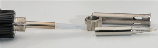

The soldering pencil itself has a moderately slender shape which feels comfortable to hold and relatively well balanced. It has a rubberised grip for comfort.
The front barrel section disassembles easily, revealing a ceramic heating element and interchangeable tip. The iron can also be further disassembled by undoing the plastic collar to access the heater connections in case the heater and sensor need to be replaced. The cable is terminated in a seven-contact round connector with a captive screw.

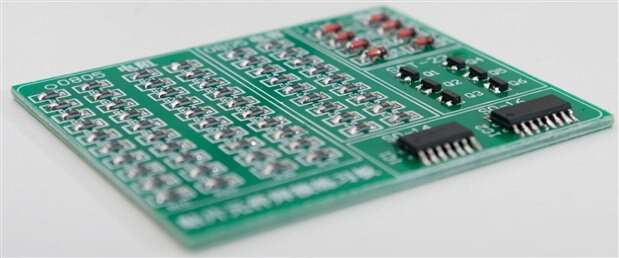

To test out the iron, I decided that I should attempt this SMD practice soldering kit that I ordered off eBay in anticipation of potentially needing to review a soldering iron. Having bodged a few SMD components on in the past and no systematic training or experience with SMD, I wanted to perfect my techniques, so the copious amount of repetition on this board should help. Unfortunately, the iron had a slightly wider tip than I would have liked - the Tenma SMD rework station came with a micro-conical which I find very comfortable to use for small components, but this iron had a slightly larger flat-tipped conical which is perhaps more abuse resistant and better at heat conduction but not ideal for SMD work. However, that being said, if I wanted to, I could purchase the finer tip at a fairly reasonable AU$7.12 inc. GST. For the purposes of this review, I decided to make do with the tip as supplied, along with some 0.8mm 60/40 tin/lead solder and a set of fine tweezers.
Given that this kit was ordered during the height of an MLCC shortage, no capacitors were included, instead they just provided the same resistors. In quite a few cases, I put too much solder, rarely too little. However, in all cases, while not pretty, the joints look to be electrically complete which is perhaps more than I had hoped for initially and I managed to lose precisely zero components. I didn't make any solder bridges nor require any desoldering braid - so I suppose it is possible with some care to do SMD work with a single iron that has a not-so-fine tip. My fear of SMD components has begun to subside - at least for 0805 and larger footprints.
In completing this project, the iron has been "christened", receiving its initial charring on the barrel and non-contact portions of the tip. Proof of its trial-by-fire.

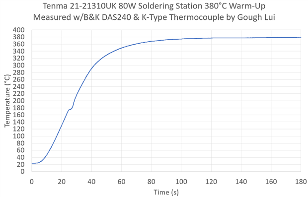

Thermal testing of soldering irons was a subject of discussion in one of the RoadTests and perhaps not as simple as one may expect. Using infrared thermometers would not result in an accurate reading, not least because of the low-emissivity of shiny surfaces of the iron, but also the shape of the iron and tip do not focus well for most laser-spot type units. Instead, a contact method is necessary - e.g. by thermocouple. There are dedicated soldering iron tip thermometers such as the Hakko FG100 (AU$455.38 inc GST) which are often trusted, but as I don't have one, I decided to try emulating a similar concept using equipment I already have.
To do this, I decided to employ the recently-reviewed B&K Precision DAS240-BAT Multi-Channel Recorder as it has high portability, resolution and accuracy compared to my other thermocouple-reading devices. On one channel, I attached a standard K-type bare-bead thermocouple and set the data sampling rate to 10Hz for some reasonable trends. My initial attempt used a very precarious but carefully arranged alignment of the springy thermocouple wire to just touch the tip of the soldering iron tip, as the iron rested across the stand in a manner not recommended by the manufacturer. This proved to be inadequate, as thermal conductivity to the bead was not assured and a noticeable temperature differential existed.
Taking a cue from the Hakko FG100 users, I decided to change the setup with the iron resting on a different support and using the stand to hold the thermcouple wire such that it instead pushed up on the tip from the underside. I then proceeded to add a blob of 60/40 tin-lead solder to the tip. This caused the temperature to read exactly as expected - note how the iron's temperature was set to 350 degrees Celsius and the read-out now matches, unlike in the earlier data with spikes due to repositioning of the thermocouple. Now that I have found the preferred measurement configuration, I turned off the iron and allowed it to cool down for two hours to room temperature before running experiments.
Warm-up testing showed that from cold, the unit was able to reach 80% of the selected 380 degrees Celsius by about 45 seconds. It was noted that the temperature display and feedback from the sensor element in the iron was several seconds ahead of the actual tip temperature, owing to the thermal mass of the tip and thermal resistance between heater and tip. As validation of the measurement process, a small bump is seen about 180 degrees Celsius which appears to be the result of the phase transition of the solder from solid to liquid, requiring the input of the latent heat causing a pause in the temperature profile. When the iron is switched off, the process of cooling down takes approximately three minutes before the 60/40 solder hardens, indicating a moderate thermal mass reserve.
In the static operation phase, temperature regulation seens to keep the temperature roughly within a two degree window, although with a slight slope over time as it may not have fully heated up. The temperature is practically spot-on, when considering the potential error in the measurement device. A calibration offset feature is available in the iron that can change the display by +/- 50 degrees Celsius but it seems it comes properly set from the factory. The behaviour when changing temperatures shows that at 420 degrees Celsius, however, seems to show the iron stopping short by about 5 degrees Celsius when given around two minutes to settle. When changing back down to 350 degrees Celsius, it seems to settle about two to three degrees above the target temperature. At a setting of 380 degrees Celsius, the iron's temperature is spot-on. This seems to suggest that the temperature regulation of the iron is quite good in general, even though the absolute temperature accuracy at the top end of the scale may be slightly lacking.

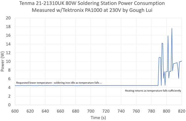

Power consumption testing was performed with the Tektronix PA1000 Power Analyser, with power supplied from a true sine wave inverter through a Variac to trim the voltage to 230V at 50Hz (within 1% for both parameters).
Starting up from a cold state, the power input spiked to 125W which tapered down quickly to just below 60W. This then dropped off dramatically as the iron approached its set-point temperature with the regulation causing the power to "blip" occasionally from a resting point of about 20W (at a setting of 350 degrees Celsius). The rapid change in power initially may be due to changing resistance in the heating element as it warms up from cold - a similar inrush current can be seen for incandescent light globes. The peak power is definitely above the 80W claimed, but the continuous running power may only be just shy of 60W based on the characteristics observed. This could be incorrect if the smooth curve is actually "active" regulation, however, from my interpretation of the data, it seems unlikely. Regardless, this still seems sufficient for most electronics work.
Changing the temperature setting to something below the current temperature, it seems that the transformer losses and logic uses about 4.5W of power. This means that perhaps the heating power is more 120W peak and around 54W continuous.
