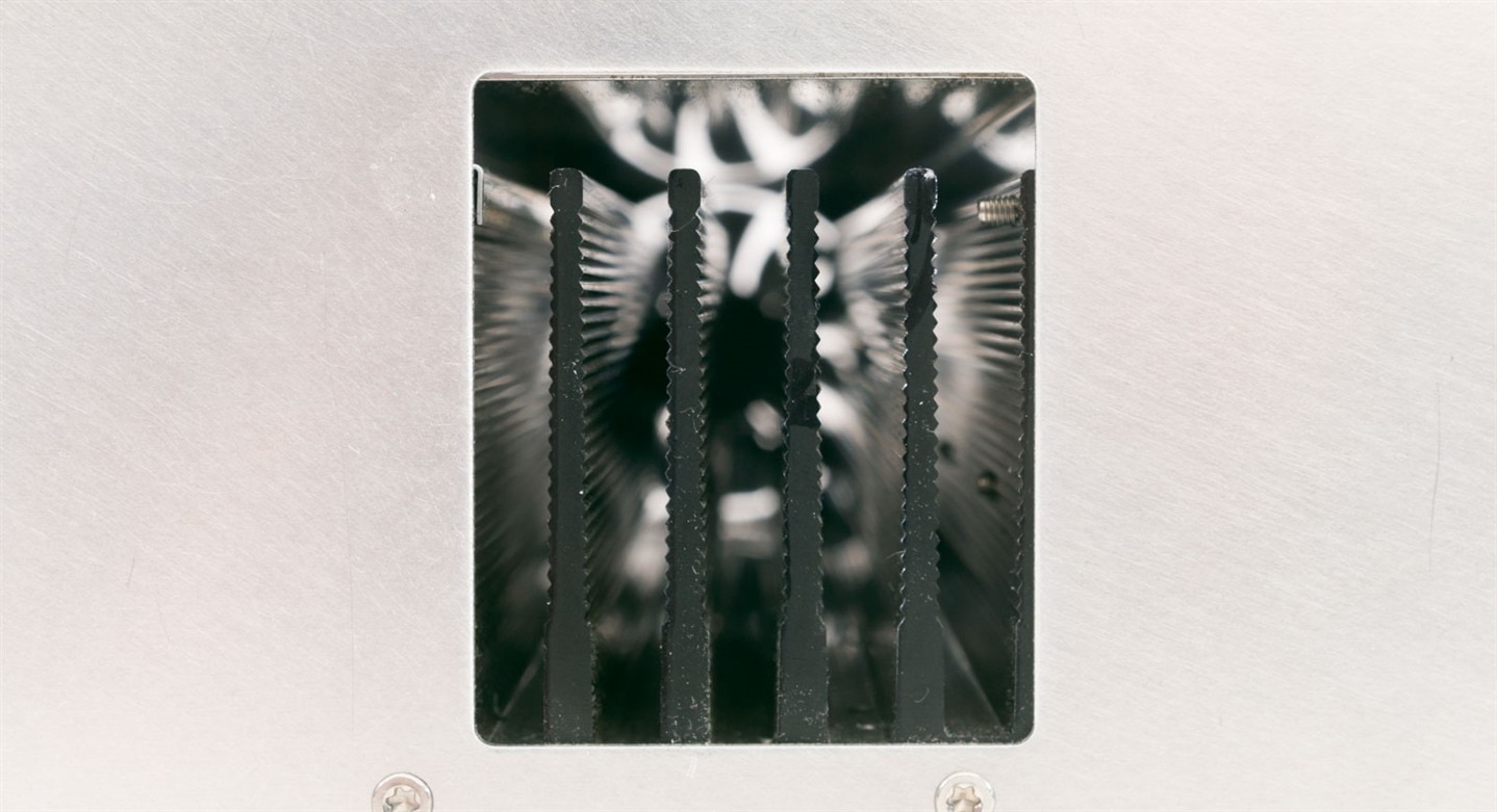

Tucked away on the side appears to be a fan control board of sorts. It even has solid capacitors and optoisolators which seems pretty fancy for some fan control. The fans themselves are Sunon Maglev series (MF60151V1-10000-G99) fans rated at 1.58W each.
There are two fans in the HMP4040's design with a vent grille on the left. As it turns out, the rear fan cools the transformer and PCBs whereas the front fan is dedicated to drawing air past a long channel heatsink that runs across the full width of the power supply. Various power semis are mounted to this heatsink using sil-pads for insulation and thermal transfer, but this design seems rather cool (if you'd excuse the pun) as it means the heat is more effectively dealt with, without creating a lot of turbulence which would create audible noise.
