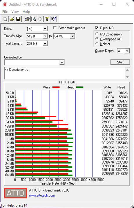

As I tend to check all my hardware prior to commissioning to avoid failures in-use, I decided to run the standard suite of benchmarks for the SN730 even though it was the boot drive. Unfortunately, it does mean the results are perhaps lower than for a non-boot drive and full-write benchmarks cannot be done, but it will stress the drive a little to see if it's any good.

The classic ATTO Disk Benchmark shows writes peaking at 128KB accesses and reads at 256KB accesses.
