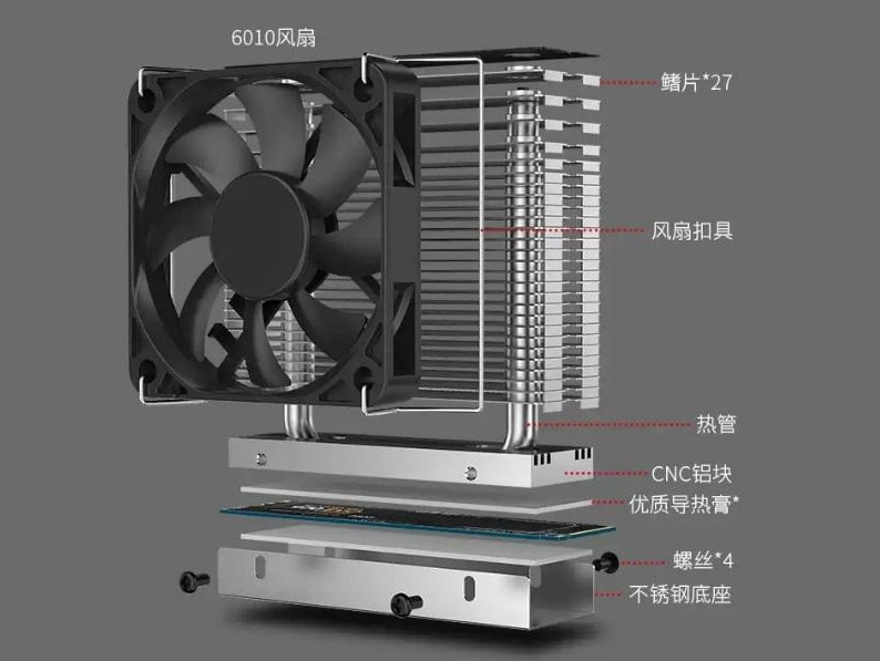

    It's crazy that we're starting to need to heatsink our storage. How're laptops going to cope? They're already embedding nVidia GeForce 30 series chips that are thermally throttling because they get too hot too quickly, and CPUs not able to reach their peak speeds.
    And I'm sure we can't find something like this on a laptop SSD:
    I fear we'll move towards remote access and subscriptions for processing being more common.
