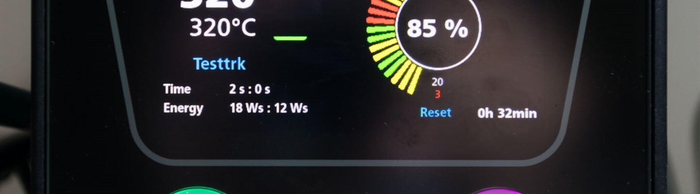

Tracking
The tracking app is perhaps the most interesting one to me as it seems to be a system which could monitor operators for their soldering behaviour and consistency.
Entering the application allows setting temperature of the tools with time/energy targets and thresholds for a red/amber/green traffic light display. Upon entering the tool, it seems both channels of the WXsmart were switched to the “on” mode. I tried setting some values I thought could be sensible.
After a bit of fiddling around, unfortunately, I found that it was not quite as good as I had imagined. I found it was frequently missing the point when the iron was being applied to a component and solder was being fed in, resulting in no recording of a joint being made. When it did trigger, the way the thresholds are applied is not entirely clear – I’m not sure if they are limit or target values. Being a new feature, it seems there is no documentation for this yet. Perhaps it’s not working so well for small SMD components, but I think this is a great feature to have if they can improve it to the point of working reliably as it gives operators instantaneous feedback about the joint energy and time.
