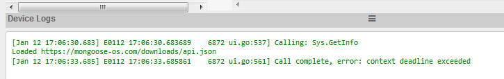

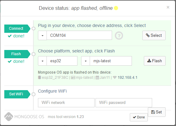

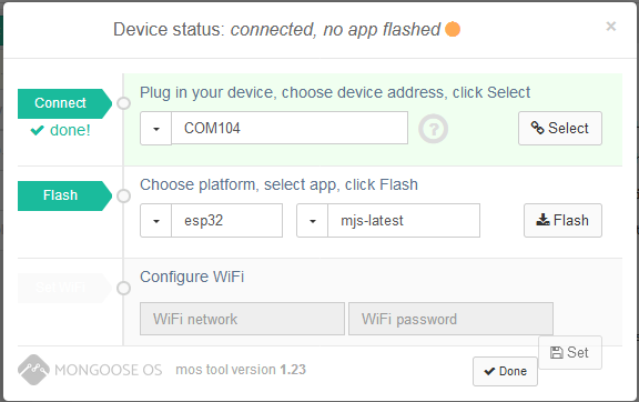

I have managed to get the OS to not communicate with the device, and then get itself bitter and twisted.
The above message is typical if the device is unplugged, the device info shows it has no idea.
Simply click on the ComPort and then Select and Done.
you may also need to press the reset button on the device
However I have still witnessed some other weird messages with the comment about starting mos ui using the terminal.
Usually a refresh of the browser and reset of the device seems to sort these out, and if not an unplug and replug the USB seems to sort it.

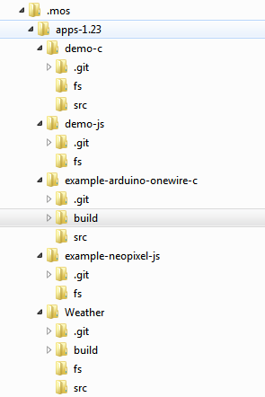

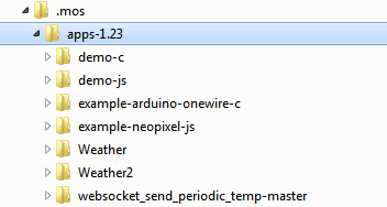

The files are stored locally at
C:\Users\xxxxxxx\.mos\apps-1.23 (where xxxxxxxx represents your username)
Personally I do not like programs that don't allow you to decide where they reside.
If someone was using a small SSD boot drive, then it wouldn't take long for these type of Apps to fill it.
There might be some way of shifting it ... I just haven't found it yet.

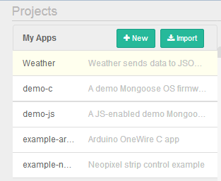

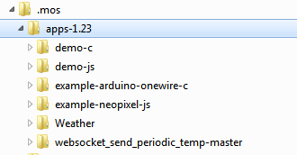

Here there is 5 apps.
which nicely lines up with the OS imageimage
In the situation where it refused to Import, there was a directory in the .mos directory, that the OS didn't know about for whatever reason.
Deleting it, allowed the Import to work, but obviously any alterations you've made will be deleted.
I would recommend keeping a copy of your own somewhere else (see below on replacing it)
Opening up the directories will show that a build has taken place for example-arduino-onewire-c and Weather
So this means we can flash them to the Device without having to go through a build process.
BUT if you want to make changes to main.c or some library, then you'll need to rebuild the App.
I'm guessing this is common sense to anyone more used to this type of programming, but if like me you've come from Arduino where the build happens after you hit Upload, it will seem foreign.

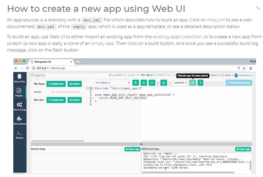

New Apps
There is a bit of documentation reagrding new apps at
https://mongoose-os.com/docs/book/build.html
my version does not seperate and show my Libs, but rather it looks like this.
Clicking on New brings up a dialogue box.
While I did build the Weather app using this method, it will work for a build from scratch approach.

I did discover that you can download it, extract it, and drop it into the apps-1.23 directory.
Hit refresh on the MongooseOS browser and it will appear.
  and the OS gui shows  imageimage
You can also copy a directory, paste it into the apps-1.23 and refresh the gui.
   and after refresh the gui    imageimage
Personally this might be the better way to copy a blank App.
Set it up as you want, then save the files, and copy the directory ready to use each time.

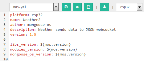

You may have noticed that the name of the project appears along with the description.
This is in the mos.yml file
You can change it with your favourite editor, or with the gui, and then save.
The name is also part of the flash, as shown in my earlier work.
The example I used had mjs-latest as the name, which also shows in the title bar.
