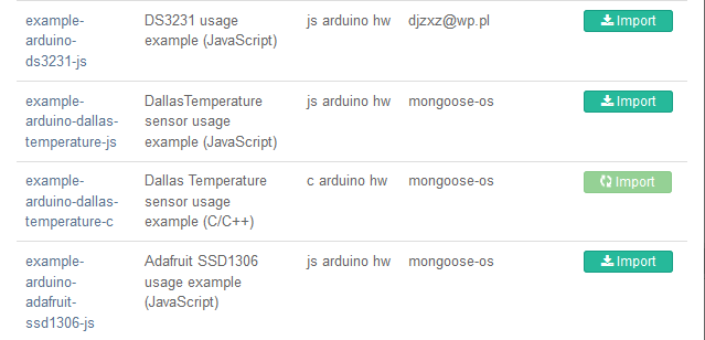

Spurred on, I decided to try a Dallas Temperature sensor App.
There seems to be a couple and I wanted to use the one based on C.
My device is currently Flashed with the demo-js which provides the uptime, free ram and total ram at regular intervals (more of why it's running later)
Click on Import and it adds to to MyApps.
Click on Flash and you'd assume that it would Flash it to the device ....
The Flash icon changes and it seems to just sit there spinning and continuing to run the Flashed program.

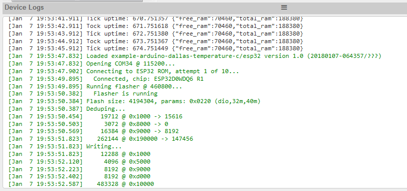

Now when you hit the flash icon, the Device Logs show the uploading process

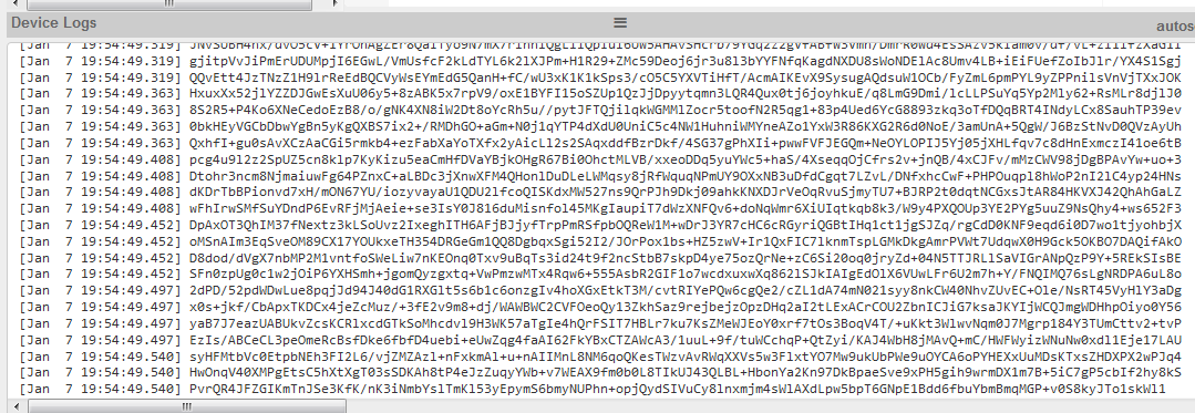

Crash the Browser
For some reason the App starts out and reports that it can't find any device, and then for whatever reason it produces garbage.
This also has the effect of killing the browser and any other open tabs you have open.
My Laptop runs an older version of Firefox, so I thought I would try running it in Chrome.
While it gave a few different looks, the end result was the same. ... Flash, run and crash.

So a new day, and I brought the cable I had at home and decided to flash the device with the demo-js app, and it should prove if it works or not.
I was pleasantly surprised when it flashed and ran quick happily (which is why it was showing the data)
First rule of fixing ... repeat the problem.
So I proved that the comm port works just fine and the device is not suffering from some other issue.
Next trick is to flash it with the App and see what happens.
The flash process went fine (after you build it) and the comm port showed some meaningful information.
However it crashed with garbage being sent down the USB port ....

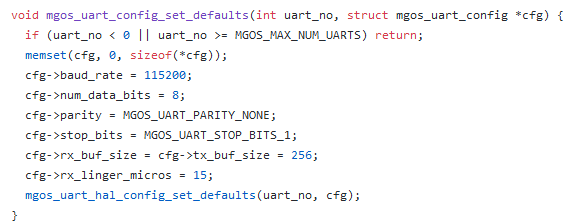

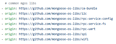

How does it communicate
The file main.cpp does not include any setting for the baud rate and simply does a printf
There is no reference to baud rate or the setup of the connection.

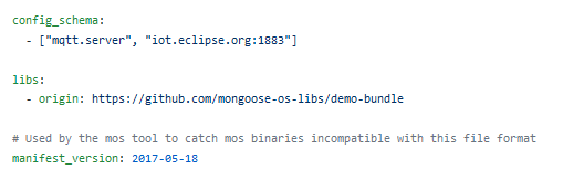

However the file mos.yml specifies the libraries used.
What differs in the demo-c or demo-js is it uses a different source.
So the next step is to check if there is a difference.
Libraries
There is plenty of links to the libraries used, and searching through them finds you back at the same uart library.
If you click on the 'api ref' in the top right corner, it takes you to here
https://mongoose-os.com/docs/reference/api.html#arduino-compat
Eventually I find the default settings for the uart baud rate in here
https://github.com/cesanta/mongoose-os/blob/master/fw/src/mgos_uart.c
and yes it is 115200, just what the port is set at.

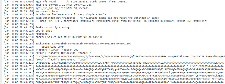

About now I'm doubting this is the problem, and why does it wait for a while before filling the screen with garbage.
So this time I rebuilt the App, flashed it and waited with my finger hovering over the reset button.
You can see the timing on the very left.
[Jan 8 00:38:13.092] mgos_sys_config_init WDT: 30 seconds
[Jan 8 00:38:13.108] No sensors found
[Jan 8 00:38:13.108] Arduino DallasTemperature library simple example
[Jan 8 00:38:43.138] Task watchdog got triggered. The following tasks did not reset the watchdog in time:
[Jan 8 00:38:43.153] - mgos (CPU 0/1), backtrace: 0x400852c0 0x400830c6 0x400fa9da 0x400fa88f 0x400faa03 0x400fa998 0x400ef963 0x400f31c9
[Jan 8 00:38:43.153] Tasks currently running:
[Jan 8 00:38:43.153] CPU 0: IDLE
[Jan 8 00:38:43.153] Aborting.
[Jan 8 00:38:43.153] abort() was called at PC 0x400d10d8 on core 0
[Jan 8 00:38:43.153] Backtrace: 0x40086b3b 0x40086c3b 0x400d10d8 0x400815e6 0x400d160d
[Jan 8 00:38:43.153] --- BEGIN CORE DUMP ---
[Jan 8 00:38:43.153] {"arch": "ESP32", "cause":29,
[Jan 8 00:38:43.153] "REGS": {"addr": 1073425304, "data": "
[Jan 8 00:38:43.153] O2sIQD5sCICwB/s/LwAAAC8AAAAMAAAA/////wAAAAD+////AAAAAJAH+z8AAAAAQQf7P+8G+z8wAAAAAAAAAPkG+z/vvq3e776t3u++rd7vvq3e776t3u++rd7vvq3e776t3u++rd7vvq3e776t3u++rd7vvq3e776t3u++rd7vvq3e776t3u++rd7vvq3e776t3u++rd7vvq3e776t3u++rd7vvq3e776t3u++rd7vvq3e776t3u++rd7vvq3e776t3u++rd7vvq3e776t3u++rd7vvq3e776t3u++rd7vvq3e776t3u++rd7vvq3e776t3u++rd7vvq3e776t3u++rd4AAAAAAAAAAAAAAAAFAAAAAAAAAAEAAADvvq3e776t3iEABgAAAAAAAAAAAAAAAAAAAAAAAAAAAAAAAAAAAAAAAAAAAAAAAAAdAAAAAAAAAAAAAAAAAAAAAAAAAAAAAAAAAAAAAAAAAAAAAAAAAAAAAAAAAAAAAAAAAAAAAAAAAAAAAAAAAAAAAAAAAAAAAAAAAAAAAAAAAAAAAAAAAAAA"},
[Jan 8 00:38:43.231] "DRAM": {"addr": 1073405952, "data": "
[Jan 8 00:38:43.231] 2fj9zRAeeeT5ay3ARLN18AAAAAB8MghAAAAAAAAAAACECPs/hAj7PwAAAAAAAAAAqcT5P6nE+T8BAAAAAAAAAEoAAAAAAAAAAAAAAAAAAAAAAAAAAAAAAAAAAABKAAAA
So it isn't garbage as such, it is the device doing a core dump after some sort of abort after about 25 seconds.
It seems that the WDT is set for 30 seconds (very top line), and for whatever reason the code assumes it will see a Dallas device, and therefore will report the temperature.
