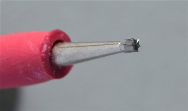

Some time ago jw0752 made contact with me and wanted to send me some of his meter probes.
He's been keeping the community up to date as he makes changes to the original concept.
Shop Tips -  Intrusive Meter Probe
For anyone that hasn't followed John's work, his background is in dentistry equipment repair, and this has been the source of his inspiration for this product.
John Wiltrout's Blog
As the blogs testify, John is very practical and has applied this to solving many of the problems faced in his life.
Good connection
Anyone that uses multimeters regularily will tell you that getting a good connection to the device under test is essential.
More importantly a poor connection can steer you along the wrong repair path, which can cost money and time.
One day john was faced with just this problem and his solution was to use a dental burr bit on the end of the lead.
This would break through the coating and allow a good connection.
Special meter probes are available from manufacturers. I haven't priced them but the one annoying thing is you need to change the lead.
I have a couple of Keysight meters, and they get around this by having interchangable ends on the leads.
I haven't looked to see if Keysight do make a special sharp probe point, but I have seen others.
They are popular in automotive uses where they can pierce the insulation of the wires, but obviously they are dangerous due to the sharp nature required.
Johns solution won't pierce wire insulation, but overcomes the safety aspect by providing a flat end with multiple sharp parts that can bite through the thin coatings found on most circuit boards, .
As you can imagine they are not some cheap piece of metal with a token gesture of hardening, they are designed for digging holes into teeth, so the copper and aluminum we encounter is like butter in comparison.

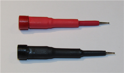

In typical fashion John's latest iteration is designed these to simply slip over the end of the existing meter lead ends which means they are a universal fit.
Good meter leads are designed to protect the user from dangerous voltages. They include a wider section to stop fingers slipping down and making contact with the metal end.
The nature of this design makes them difficult to use one handed, and I can only imagine what happens when hand dexterity becomes an issue.
To give you an example of how useful these are, I tried measuring a resistor while it was sitting on the bench.
Modern probes have a reduced diameter near the end, and you can try angling the probe to utilise this to make contact, but if you tried this while it was in circuit, it wouldn't work.
Johns probes simply slip onto the end of the probes, and the task is not only possible, but the pressure required is significantly reduced as well.
It becomes so easy that it can be done one handed without much effort at all.

    I've got a set of John's lovely probes as well and I find them absolutely brilliant - best probe I've ever used. I looked into making my own and I solved the dental probe socket issue with these standard…
