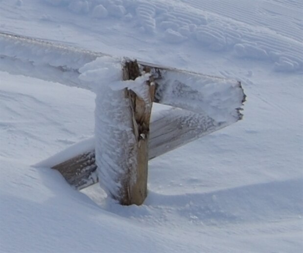

One thing many people don't appreciate is how hard it is to work on equipment out in the cold and snow.
Generally you need your gloves on, and if you drop something its gone.
Things that require small screwdrivers, need to be assembled from several parts (ie washer + lock washer + nut), or that buildup ice preventing the tool from properly engaging (small cap screws) are best eliminated from this environment.
So the hardware needs to be designed for the intended environment.

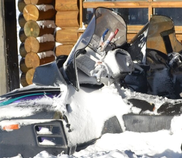

Snow comes in all forms, from wet heavy large flakes, to very fine dry powder that the wind blows into the smallest opening.
This ski-do was under cover and on the lee side of the wind.
Either you allow it in and ensure there is a drain for when it thaws, or you need to fully seal it.
I need to add drain holes, polystyrene packer, and a cover over the back to prevent ice buildup behind the photovoltaic portion of the panel.

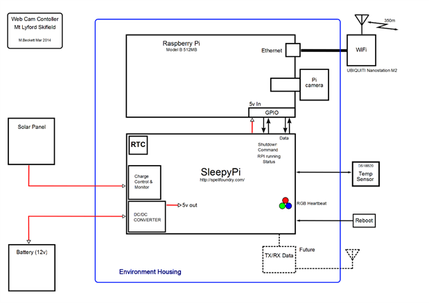

SLEEPYPi
Jonathon Watkins from SpellFoundry contacted me last year and very kindly offered me a beta version of his SleepyPi to include and test.
This had the very items that I was including as extras, so it makes a very neat solution.
There is an area for prototyping, so I can add a charge control relay and terminals, and it interfaces directly with the RPI.
He even includes the scripts to do the controlling.
I have updated the drawing to include this, the external WiFi unit, and better heartbeat/problem indicator.
Earlier in the design phase I wanted to include the ability to have the RPi do video, and I wasn't quite sure how I could do this with an external device controlling the power.
Using the scripts Jonathon has included, I simply ignore the shutdown signal while its running a video.
The RPI returns a signal to the SleepyPi that its running (or not), so the power won't get pulled until this disappears.

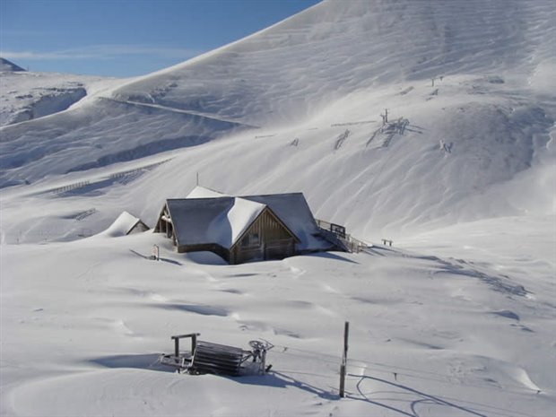

One of the things that has worried me is the power consumption overnight, and if the skifield is closed due to extreme weather.
During this time there is unlikely to be a charge going into the battery, and while it has a large capacity, the solar panel will be struggling to raise it and run the electronics.
In June 2013 the area got the biggest dump in 30 years, and it took nearly a week to open the road and clear the drifts, hence the need to conserve power.
This was taken by Hamish as they helicoptered in to start clearing the place

    shabaz over 12 years ago
    Hi Mark,
    I was just going to suggest it, then realised you already had it on the diagram, the out-of-band transceiver for remotely powering up the unit : )
